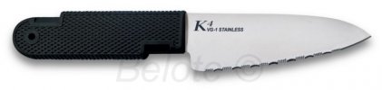

Cold Steel (bad segue from Tom Krein, I know) turned one of their small kitchen knives into a neck knife. It was a good move. I may buy one.

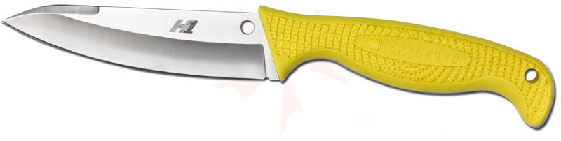

I was in Target the other day, and spent a few minutes looking at a neat little paring knife. It was vaguely reminiscent of a Mora Clipper.
The thing was done up in lime green, blade and all. It was shaped so the blade could touch down on a flat surface. It looked VERY well designed for kitchen tasks. Although it was thin and very flexibile, it had a wicked grind and point on it that would make any commando grin.
I couldn't help but think how much I would like to have a bigger beefier version out in the woods.
(I would have bought the thing, but I had my arms full of necessary purchases and I was rapidly heading toward flat broke :D )
This CAN be done, and I think you can do it without diluting any "tactical", or hard use utility.
If the blade offset is enough, the blade itself would act as a guard against slippage.

I keep a CS K4 necker in my bag at all times, as well as a mini Epicurean cutting board. Works great for on-the-go food prep!

I have actually looked for such knife. Cold steel seems to be ahead with their K4 in neck sheath and several other models (Roach Belly, Canadian, and Long Hunter). I settled with the Roach Belly.
If you read on the history of the Long Hunter, it was an 18th century French kitchen knife.
