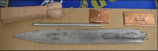

OK, having read the posts several time I now understand what you mean(hopefully). New problem: The guard I planned to use is copper(bad idea? {I don't have any bronze.}). It's gonna melt when I have the bolt brazed on. How sturdy is the hook idea? Do I need to extend the tang into the handle a little to make room for it? I need to HT before installing the guard and rod, right? Doesn't the brazing harm the HT of the blade?

May just be me, but I don't think you have enough tang. That looks pretty weak to me.
1/2" shorter blade, but 1/2" longer tang. Still about 1" longer than originally planned, but who knows how many times I will have to regrind the tip. . . . Note there is a different guard as well, don't know why I thought a guard needed a hole instead of a slot.
I'm real confident that's not what most of the guys were picturing when they answered...
Personally, I would not feel confident in that blade. Sorry :(

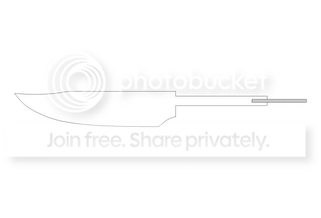

That is not what I was picturing either, I had something more like this in mind
Where you are only extending the tang a couple of inches at most
This was just a quick edit to a drawing I already had to add the threaded part. I am assuming that the welding would be done after HT too because I don't know how the allthread or bolt would stand up to HT
I'm sorry,too.
I do not suggest that sort of attachment. You need at least 1.5" of tang before the rod joint. It will break as it is now. I would cut back the shoulders a minimum of 1" to finish it, but would not sell the knife under any circumstance. Do the weld, and then grind back the shoulders.
Just weld on the rod and then grind in from the sides to make a 1" long by 1/2" wide tang. The change in length won't be that bad. BTW, if you melt the copper when attaching the rod, you are really getting things way too hot. With some ca and a bit of skill, you should be able to weld the rod to the tang without ruining the existing HT. A MIG welder is an advantage here. Wrap the blade in a wet rag while welding the tang extension.
