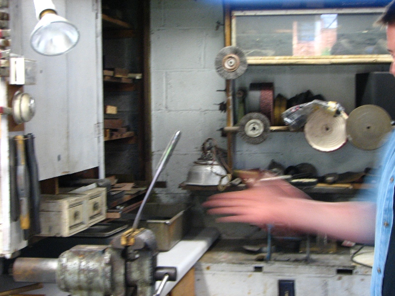

90 deg bend test.
It sprung back...
http://www.pattonblades.com/test-3.JPG

I used 5160 and treated it as follows.
I forged it from 1-1/8"ish round stock (it was a John Deere load shaft cut off that I got from Dan Gray a while back) . I thermal cycled it three times, using lowering heats, (1600, 1525, 1450) After annealing, I ground it right about to the finished thickness, coated it with antiscale compound, soaked it at 1525 for 20 minutes or so, then edge quenched using a limiter plate in Shell Voluta 201 quenching oil. I tempered it at 350 3 times. I actually made two blades at the same time, forged from the same bar, and tested one of them at home before going to Kevin's. The one I did at home was slightly thicker, and it still flexed/bent just fine, so I knew the other one would be good too.
Both these blades have really cool quench lines. There's two lines, and they intersect about 2" from the tip.

I used an Evenheat oven. I coated the blade with antiscale compound, and soaked it at 1525 for 20 minutes or so.
