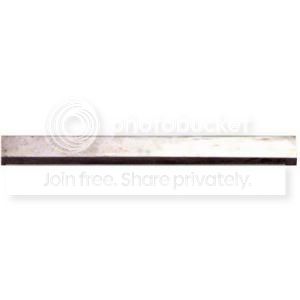

A couple of these 2 1/2" carbide scraper blades from a home improvement store attached to some chinese 123 blocks should work as well as anything for about 30 bucks.

thanks for the great info. i think i might get the bubble jig, and some 1 2 3 blocks
