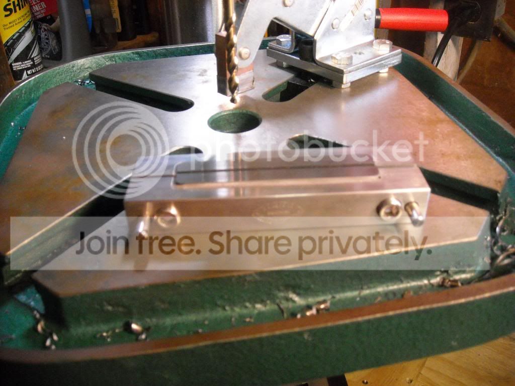

I couldn't let it go. So, I whipped up a new file guide last night (above design). I'll post some pics soon. Materials came super cheap.
Drilling the bolt holes might be problematic. Maybe if you used mild steel and JB Welded the file to the face. You could leave the mild steel a bit longer than the file. On second thought, this file trick might leave marks on you knife that aren't easy to get out.
That's almost exactly what I did :) plus drill pressing the bolt holes. Will have pics soon. Also, I left a gap between the scrap file faces and the clamping face of each guide bar. The old files won't touch my blades that way.
I spent about $10 on materials, but most of you should have this stuff laying around. When I get off my day job today I'll go grind the faces flat and parallel while it's all bolted up.

Just for kicks, here's my guide from Uncle Al along with the one I made. I like to tinker too :)
