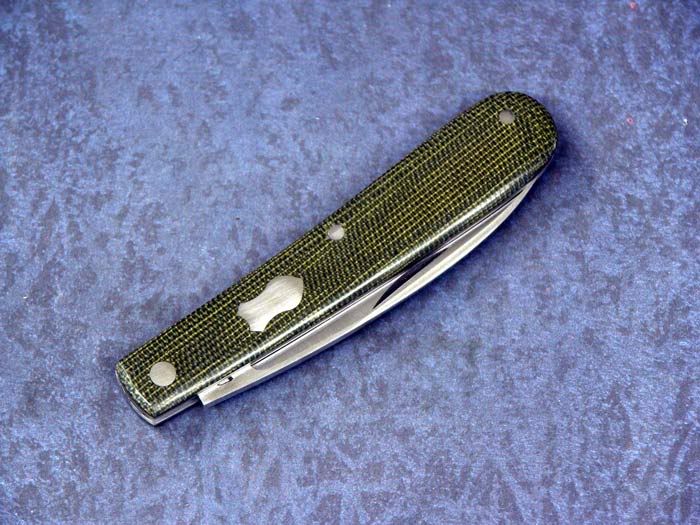

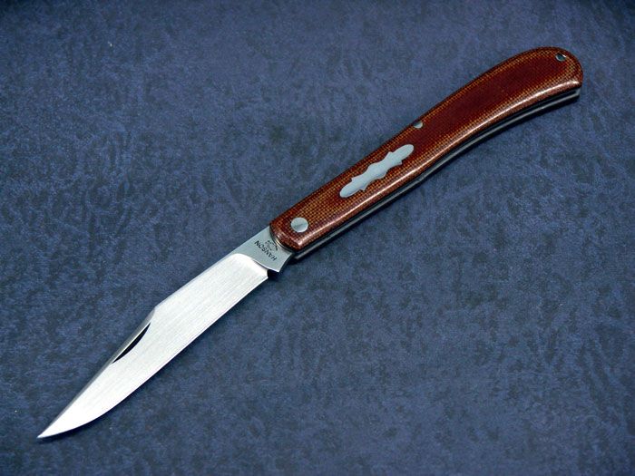

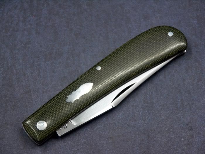

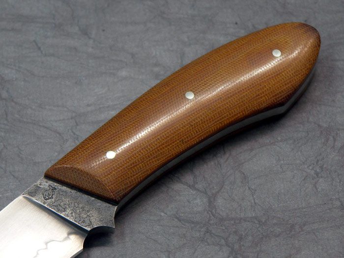

Many of the pieces of micarta shown in this thread are natural. Natural micarta is yellow when first made or cut. It gradually turns brown as it ages. You can get natural canvas, natural linen and natural paper micarta. Micarta type phenolic composites are currently made by a few companies. Norplex owns the Micarta® trademark.
