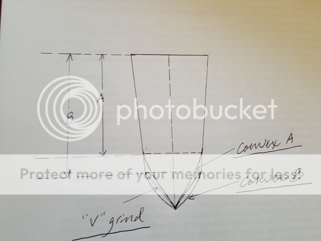

A convex egde could have more or less materail than a V edge or even equal material, all depending what you are comparing. See the diagram below (sorry about my hand drawing).
Lets say for the same blade, (1) if we want the primary grind to be the same, which is Case B, then a convex edge will have more material, whereas (2) if we want the angle at the blade tip (apex) to be the same, which is Case A, a convex edge will have less material.
The argument throughout this thread is like saying "A's daddy is stronger than B's daddy" for which A is comparing his daddy in the age of 20 with B's daddy in the age of 60 while B is comparing his daddy in the age of 20 with A's daddy in 60.
I really don't see why this is hard for some to grasp.

First off, I want to say that Marinek's math is absolutely spot on, and anyone who at least paid attention in high school should see that plainly.
When you understand all of the above, you realize that, at comparable edge thicknesses, Convex edges do inevitably feature more metal just behind the apex, which does potentially help a metal deficient in apex stability for a given use (such as many Carbons or, in my experience, several CPM steels). For all other considerations, it is of course inferior in cutting performance (and sharpenability) to a V edge, because the theoretical "drag" of the V's side ridge only affects the dynamics of fluids, and fluids are not what knives cut...
