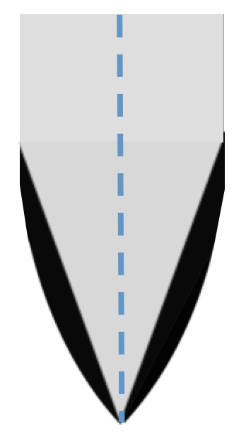

The sharpening angle is the same as your edge angle. Also, these images were drawn using state of the art drafting software (AKA Word), so please excuse the eye pain.
Just before we start, going from a V edge at 20 degrees to a convex edge does not create a 20 degree convex edge. Alright, let's go.

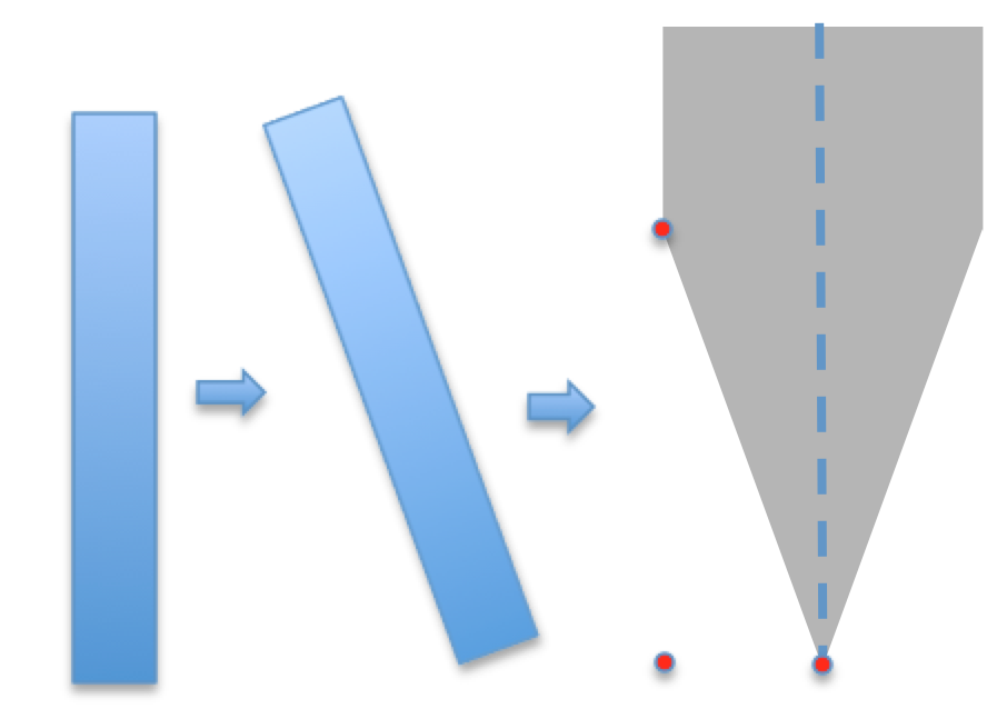

A "V" edge is formed with solid, flat abrasives. If you hold the knife at 90 degrees, and angle your sharpening stones at 110 degrees and 70 degrees (left and right sides of the blade), and then sharpen, you will get a 20 degree edge (40 degrees inclusive). (See below image)

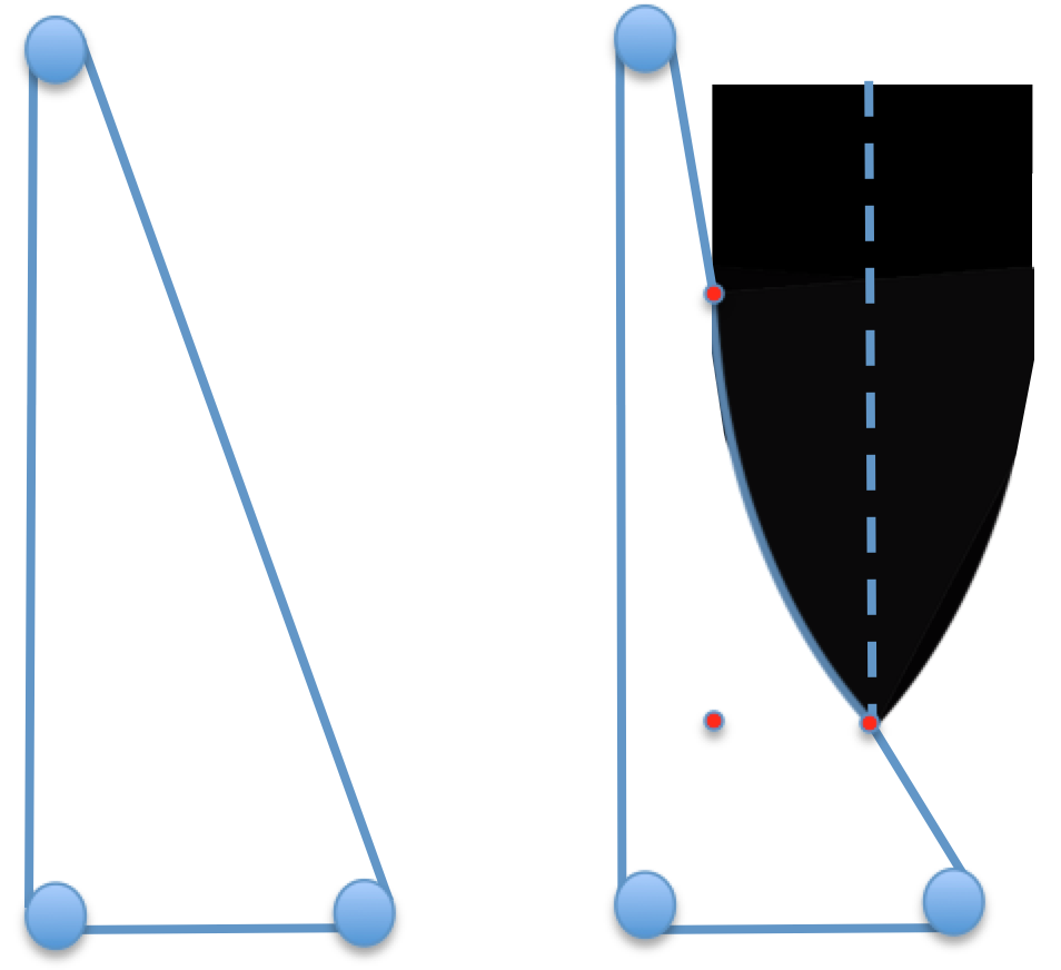

A convex edge is formed by a belt system (or some type of system with a tension or "give" to the abrasive surface). If you hold the knife at 90 degrees, and angle the belts at 110 degrees and 70 degrees (left and right sides of the blade), and then sharpen, you will get a 20 degree convex edge angle (40 degrees inclusive). (See below image)
So, take sharpening systems that produce a V edge and convex edge, angle them both at 20 degrees with respect to the blade, and here is what you get:
As you can see, the convex edge clearly has more material behind the edge than the V edge, with the same edge angle.
I drew the pictures to scale, so feel free to compare the angles on your screen. The red dots represent the points on the original knife blank (also at the same 20 degree angle).
I welcome any corrections or alternate views as to why this could be wrong (provide some sort of proof though).
Also, this does not take into account convexity, because that does not matter. Technically, you could apply this to a hollow grind too, where a wheel would be used, and would contact the knife at the two red dots as well. Changing wheel diameter would change concavity, but hollow grinds are a bit different, so it wouldn't be completely accurate.

The apex angle is not the same in those pics. The convex edge has a more obtuse angle at the apex, which is why it has more metal behind the edge.

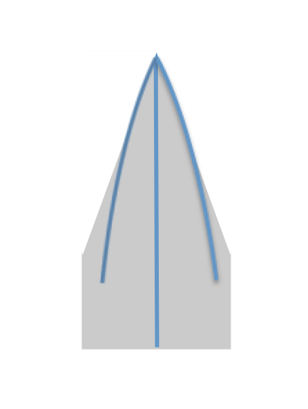

Ah, so you are thinking more along the lines of this:
Thanks for explaining. So with this interpretation, keeping the apex angle constant, changing the elasticity of the belt system would be directly correlated with changes to the blade stock thickness and convexity. In my interpretation, changing the elasticity of the belt system would be directly correlated to changes in the convexity and apex angle.
Apex angle, convexity, and blade stock thickness appear to be the three variables, and the depending on what you set the independent variable as determines the blade shape.
They don't have the same edge angle. The black part, the convex, has a more obtuse edge angle.
The belt leaves the apex of the edge at your red dot on the bottom right is a more obtuse edge because the belt deflects into the triangle formed by the belt pulleys. This causes the belt to meet the bottom right pulley at an angle more obtuse than the 70 degrees it would have met were it not deflected. To get the same edge angle you need to start lower, maybe 60, so the angle after deflection is 70.

No, you can very easily make a convex on stones. Just hold at your desired edge angle and then drop your spine as you work that region of the edge. That action ensures that your bevel angle is what you want at the apex, but rolling the spine lower blends back the shoulder.

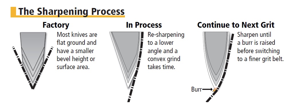

Check out this image:
https://1.bp.blogspot.com/-IW3nHNLnmmU/VtJbA1P5LeI/AAAAAAAAG5o/UzvCPNw7ik8/s1600/Bevel-vs-convex.jpg
This is from the work sharp system, it kind of shows how you go from a V edge to a convex edge, and you can imitate the action of the belt with your hand. Imagine the point of contact with the stone you are using following the belt line, if that helps. The belt will be MUCH faster though, because it is applying force over the entire convex surface, whereas the stone would only be touching a point at any time.

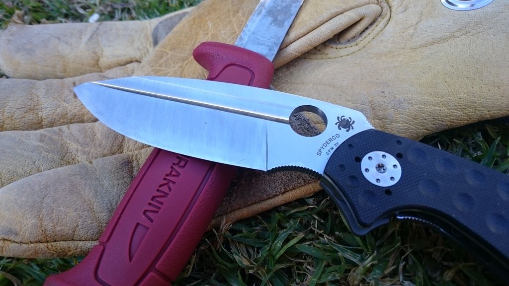

I love a flat convex with a micro bevel for my typical light use EDC's. No bevel shoulders means minimal drag in the cut, so they are great slicers. The micro bevel is quick to sharpen. Probably half of my 30 Spydies are convexed like this.
The Sage and Stretch below are very thin, and almost border on zero grinds, so I have to treat them with common-sense. A 15 dps micro bevel gives enough strength to prevent chipping in my day-to-day uses. Love them!
