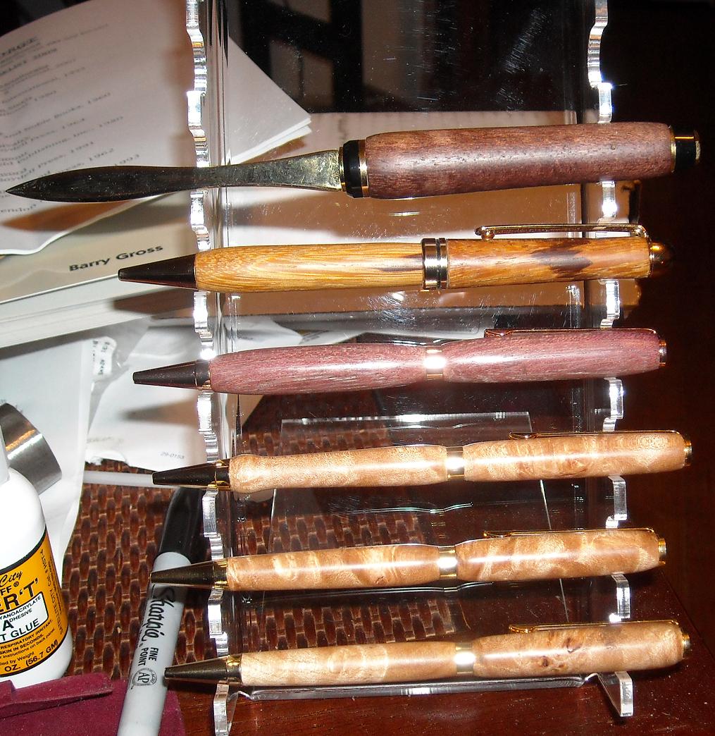

Well... in my R&D i've discovered that people will buy a lot more 20 and 30$ hand made pens than they will 150$ or so hand made knives, and the profit margin is larger on the pens too... So i've been making a bunch of pens for people at work in the last few weeks with the time i'm usually in the forge =P Next to start making pen knives and combining the two !

Right now all my research is going towards building a gas forge and heat treat oven to take the place of the coal forge and and toaster oven. Also lots of time spent on blade designs and handle configurations. Oh and Justin those are nice pens.
