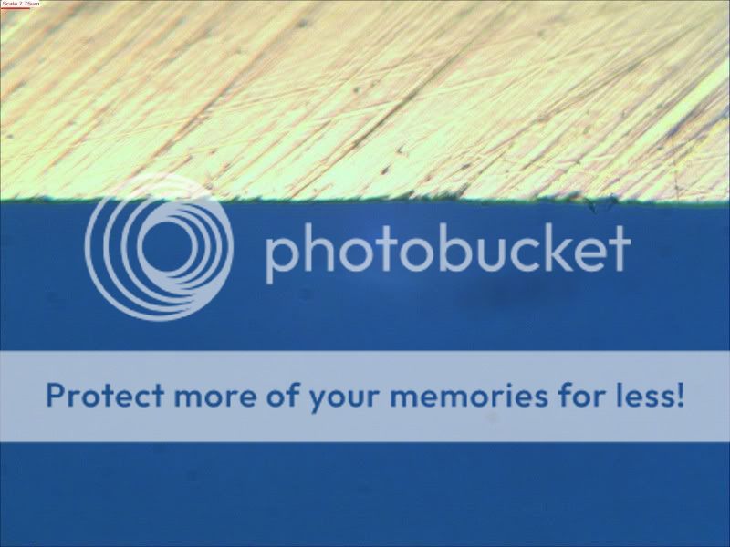

Here's my latest (I try a lot of stuff). The stone and swarf slurry from my waterstones worked very well, but the wet paper allows too much rounding of the apex, and its not practical to sit and wait for the paper to dry before finishing an edge. Dry paper works better, but has a harder time deburring and doesn't work very by itself well for maintaining a microtoothy edge.
I also noticed something peculiar when stropping a coarse edge with newspaper wrapped around a SiC stone for more firm backing. Using a bit of pressure worked great until small V shaped microburrs started to form perpendicular to the edge - thin(er) spots in the bevel where a large grit dug deeper than its neighbors collapsed under the pressure from the uneven surface under the newspaper (one layer). This is not good, but it did lead to two conclusions - don't use too much pressure stropping on a hard, uneven backing under newspaper if you have a coarse edge on a fairly acute inclusive edge angle, the pressure spikes will cause trouble - and... this might be a principle I could make use of...
Bring on the crayon-type compounds.
I rubbed a single sheet lightly with some Sears white compound ( I estimate it at 1-3u), wrapped it around the fine side of a SIC stone, and stropped just hard enough to feel the texture of the stone through the paper. After a dozen passes I wrapped a second, undressed sheet of newspaper around the first and stropped on that, again just hard enough to feel the texture of the stone. This works absolutely wonderful for creating a relatively refined toothy edge - looks very much as it did fresh off a 4000 grit waterstone and stropped on plain newspaper. No rounding of the apex, and no erasing the grind pattern. The pressure spiking of the stone texture under the strop abrasive causes it to carve into the edge without issues of rounding the apex or polishing the scratch pattern too much. I did a few other tests using both sides of the stone with different sized stropping abrasives on edges prep'd from different grit stones. In every instance it worked very well at preserving/refreshing (in truth, regrinding) the scratch pattern without raising a new burr or rounding the apex. I suspect I could use a smoother stone (my Spyderco Fine) in conjunction with CrO to do the same treatment on an edge coming off of the 6000 or higher waterstone, and will be testing this soon. I went down as low as 120 grit SiC dust and was able to cut a coarse edge into a previously dull blade and coax it to cut arm hair and pushcut newspaper with the grain (had to draw cut to go across the grain).
All pics at 640x - scale at upper left is 7.7u
Original edge sharpened at 4000 and cleaned up on newspaper strop - could pushcut TP and part freehanging TP with a light swat:
Same edge after much tinkering with some Flexcut gold compound - a bit too refined for my purposes, but a nice edge nonetheless - could pushcut TP more cleanly but was starting to have trouble swatting a free-hanging piece:
Same edge after the white compound - no rounding and very microtoothy - almost a dead ringer for the original edge straight from the stone in looks and characteristics. In truth it performs better, and the grind pattern is almost entirely created by the stropping procedure :
