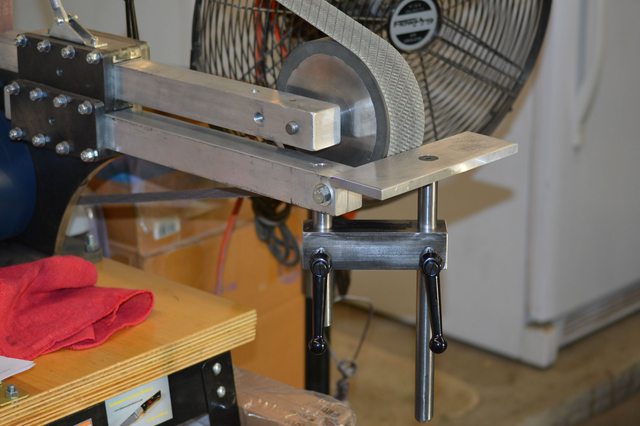

I believe that good grinders have a second tool arm slot...something that us knife makers did not have ten years ago when we bought a 2x72 belt grinder. So I want to say that the most important improvement for me in the last couple years was this tool rest that I copied from the one offered on the TAG grinder by Chris Williams. Mine does not swivel to and fro for angles but swings out and up for all the wheels and my platens. I have built and used at least six tools rests in the past ten years and now I use this one for 95% of my work. Here are 2 photos of the rest. The last photo is my angle rest for swedges. Larry
I need to copy that rest Larry. I built my grinder with 3 tooling arm slots but just essentially laid a piece of flat stock on a tool arm for a workrest to get by with. I especially need help with my swedges.
