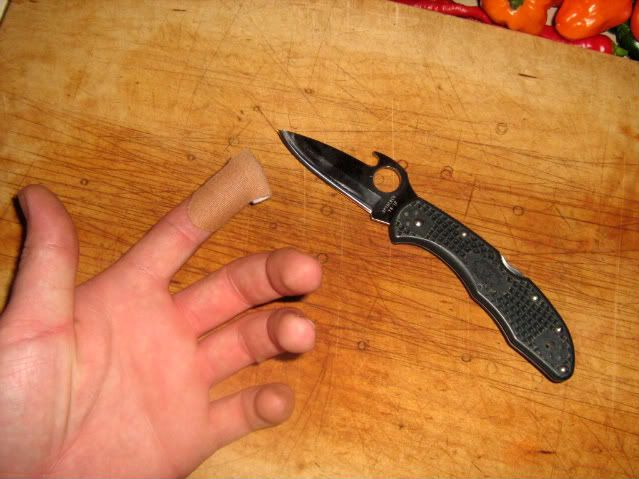

I did unplaned surgery with my delica today :(
Note that there was no damage to the blade.
