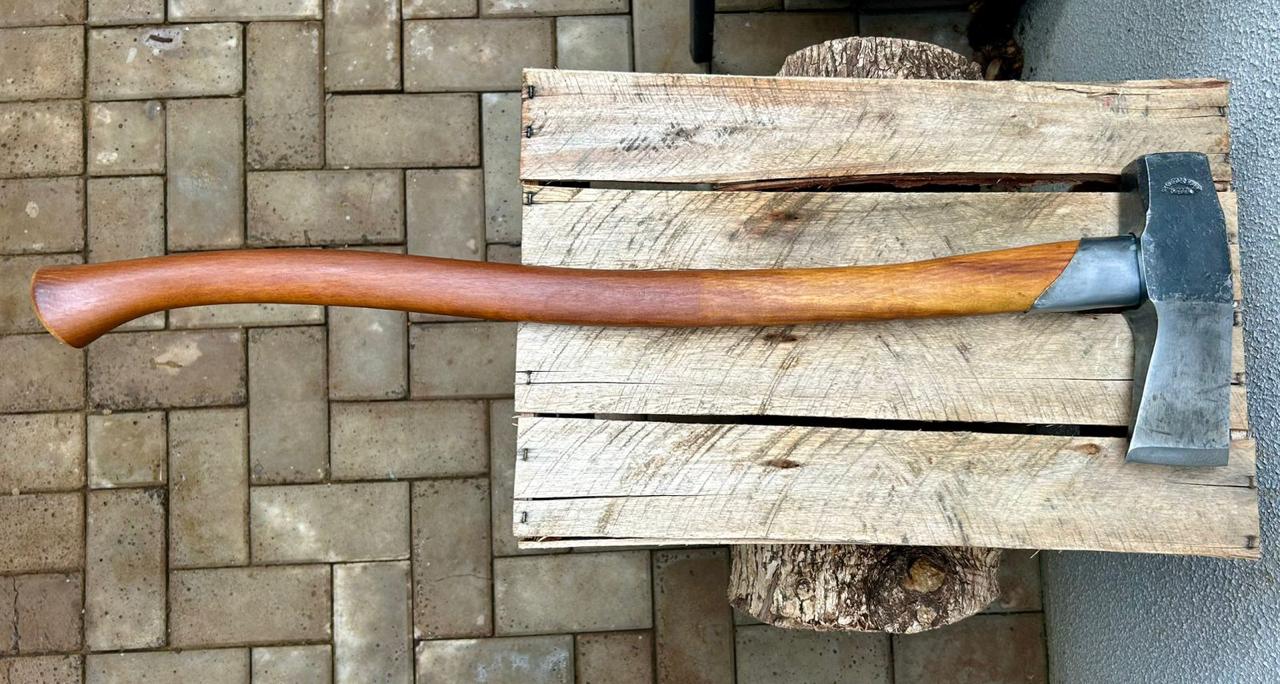

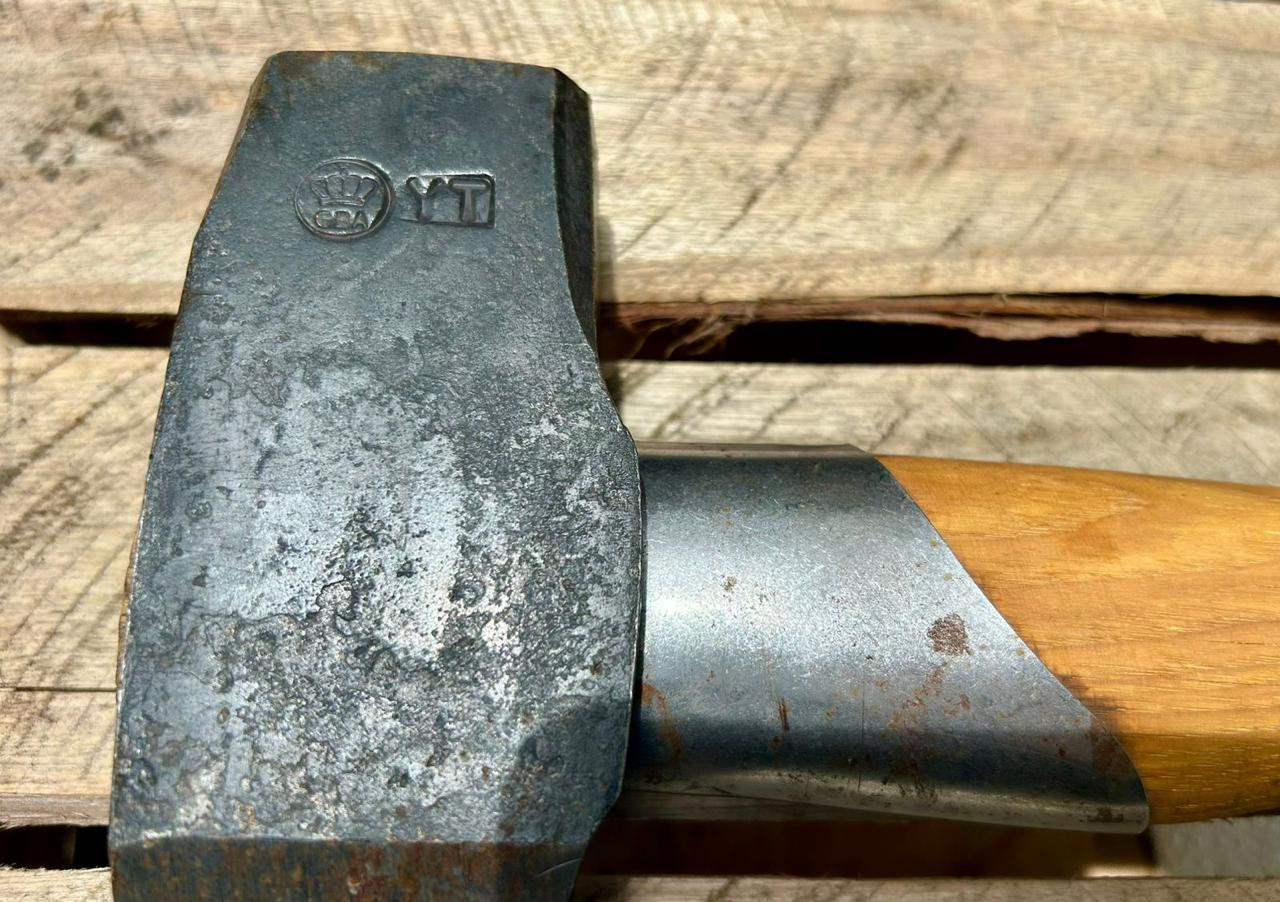

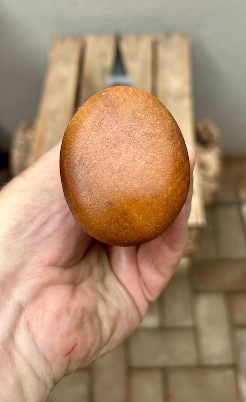

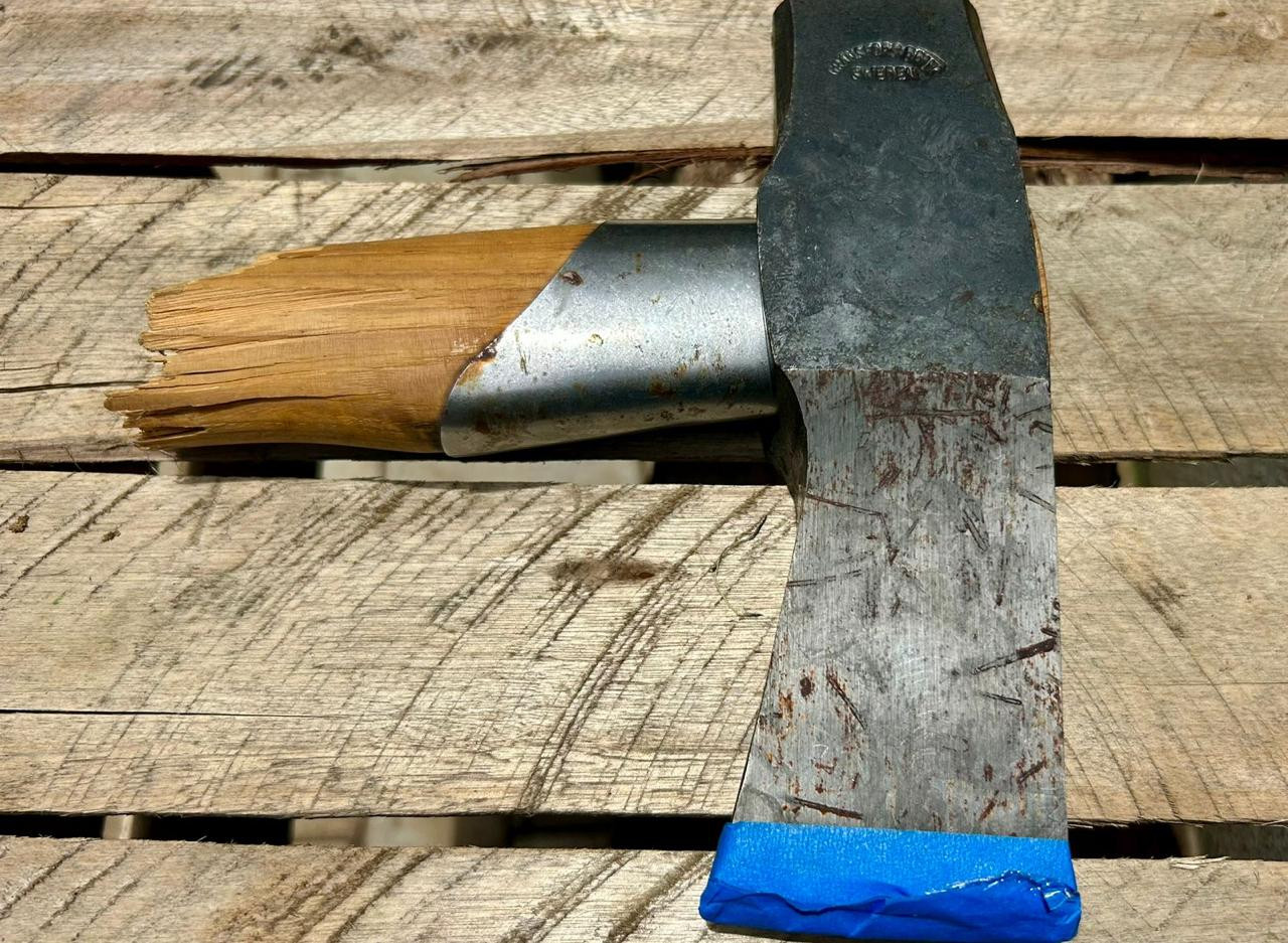

I shouldn't have had to rehang this, but I broke the original Eucalyptus handle with a nasty overstrike while limbing on the first day using it. It's not the handle's fault it's mine because the axe got deflected into another heavier branch that impacted right at about 1/3 of the way up the handle. So I quickly made up a Green Ash replacement and it's back to chopping. The handle is sticking out proud over the top because the wood was stored outside in a shed and will probably shrink a bit being stored inside through the winter and I want room to drive it on farther.
This is a Verdugo 1800g I got for Christmas and that was purchased from La Cognée in Quebec. I filed an 18-19 degree flat grind on it with a small steeper bevel and it is a fantastic chopper so far.

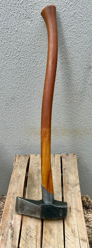

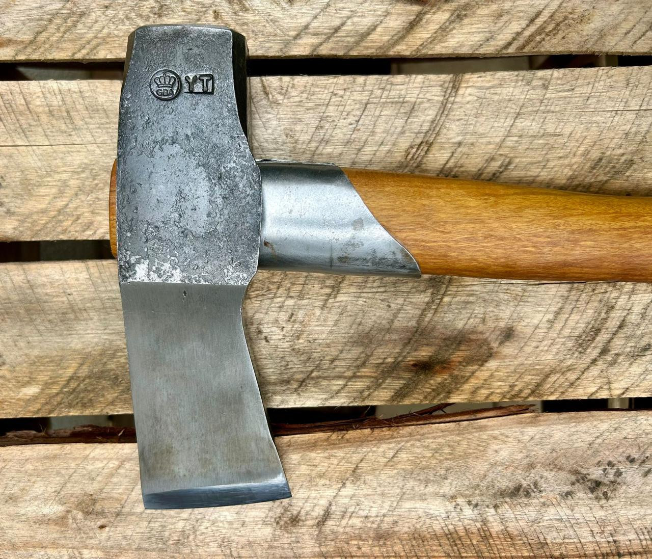

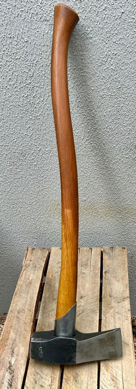

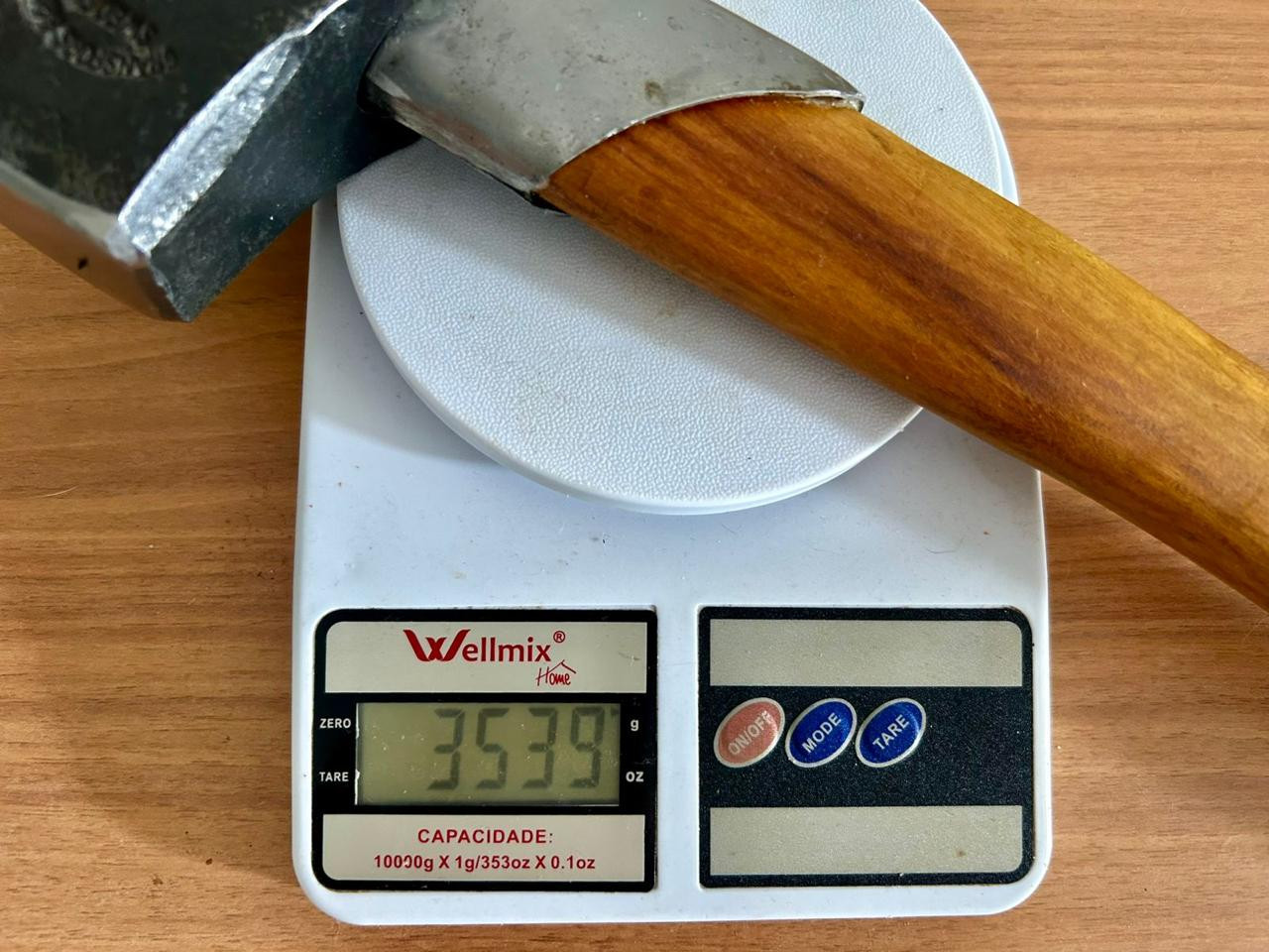

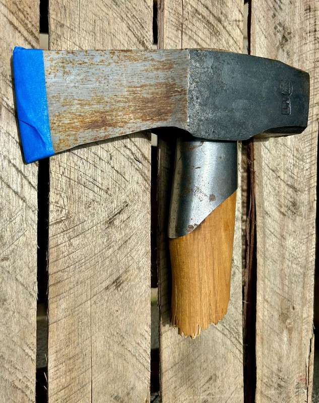

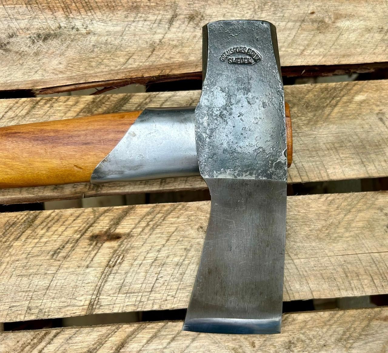

The other day, my 28” primary chopper & wedgebanger handle broke, so I’ve had to make do with my 36” axes.
I couldn’t take it any longer, so I did a thing:
Now, my cordwood challenge can recommence.
