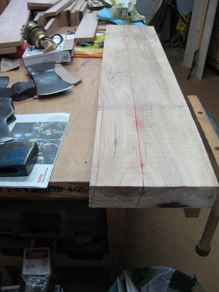

When your handle starts out as a quarter of an Ash or hickory round, the plane sees a lot of use if you want the sides of the handle to be straight and true . . .
Thanks for sharing that article. Interesting read. Which of those heads is that handle destined for?

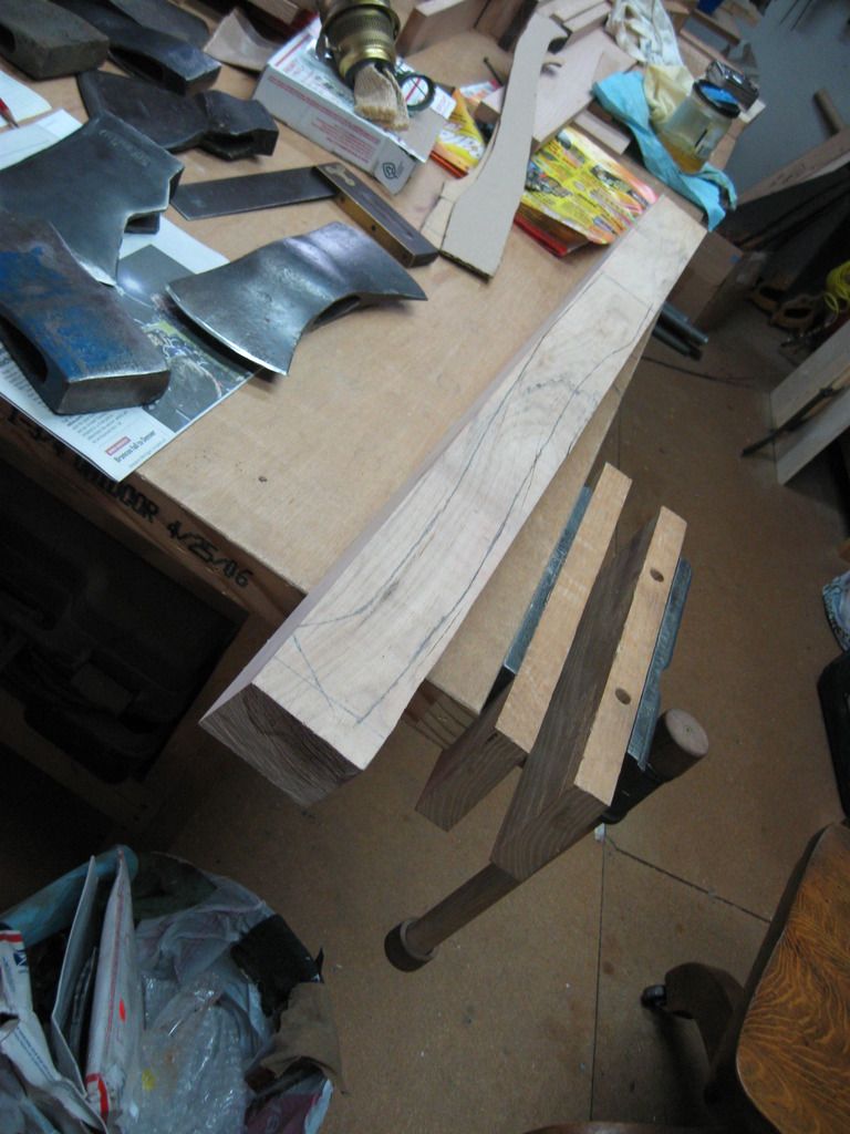

Then I cut the profile on the bandsaw. I'm now shaping mostly with a rasp. I have draw knives and spoke shaves, but I don't seem to have the touch to get a smooth surface and end up sanding to remove the facets. The handle seems to get about two hours a month of work, so I might be posting a finished picture in a year or so.
