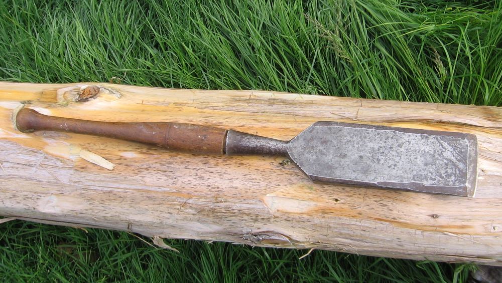

That is what most folks would call it. But different manufactures at different times may have tagged it by another name. And so it can be a can of worms...That would be a firmer chisel correct?
Ooohh you done it now!....and without meaning to open that can,i'll mention that it may technically qualify as a "slick".The difference is that the slick is ever so slightly curved, convex, along it's sole(best told sighting down the sole).Firmer,or most other chisels,are strictly Flat-soled.
(Slicks are for somewhat rougher/preliminary work,built to ride up and down the unevenness a bit).
. . . and/or the handle socket is cranked upward.the slick is ever so slightly curved
Firmer chisel. That is what most folks would call it. But different manufactures at different times may have tagged it by another name. And so it can be a can of worms...
Now that I'm thoroughly confused at what point does something like this qualify as a 'bark spud'? Which is probably what I'd be using it for.....and without meaning to open that can,i'll mention that it may technically qualify as a "slick".The difference is that the slick is ever so slightly curved, convex, along it's sole(best told sighting down the sole).Firmer,or most other chisels,are strictly Flat-soled.
"Can of worms"!
(the handled one at least is cranked-up a bit at the socket.
I'd still call these slicks,from the common usage of the term,vs technical distinction.And,not having experience using anything but the slightly-curved ones,i'd say that these are for more precise work,for running some truly flat surfaces.
