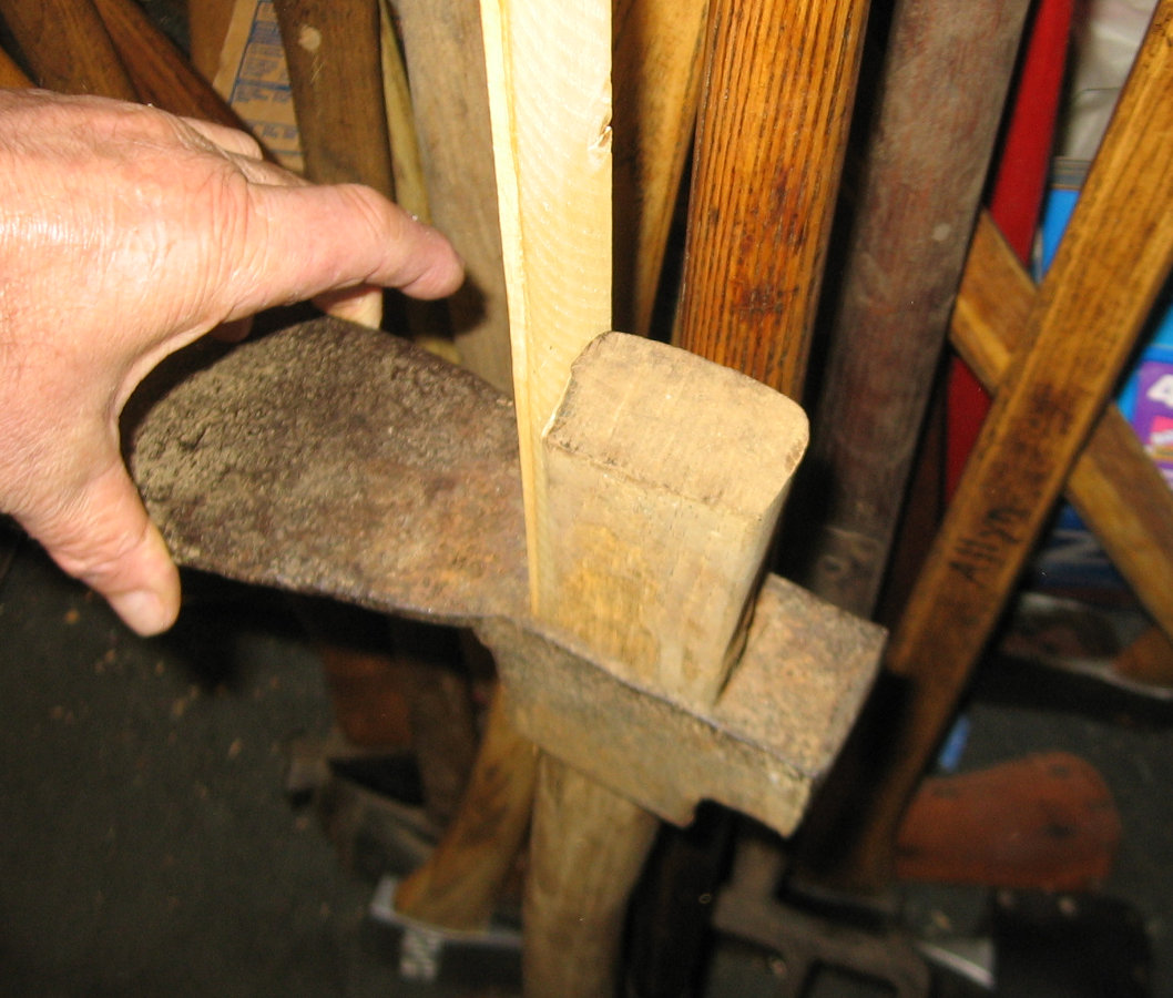

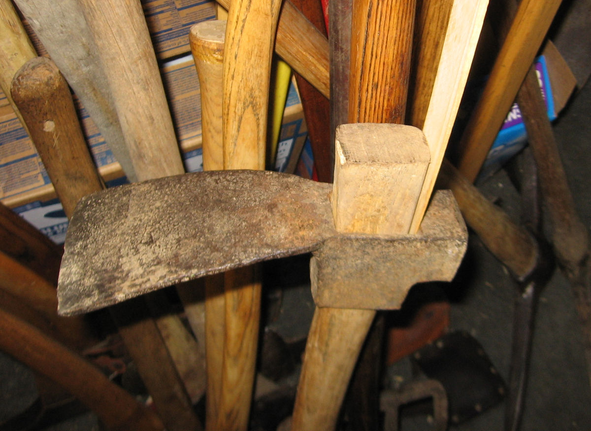

I am not a carpenter adze user but FWIW on a recent visit to an archeological site of an 18th century French fort (https://bladeforums.com/threads/the-members-discussion-thread.1644464/page-14#post-19180572) I got to talking to one of the archeologists who studied and practiced log building techniques of the period. It was pretty easy to get him talking about the tools and during our chat he mentioned something I hadn't heard before that because adzes had rectangular eyes their handles could be rotated 180 degrees to give steeper or shallower angles for the blade entering the wood.
Here is a comparison I did with an adze to illustrate the two positions:
Just thought this was interesting and might add to the discussion.
