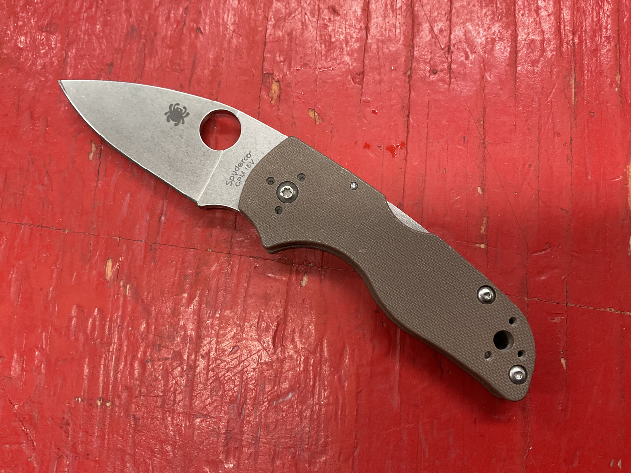

I finally decided to try TSPROF's single, center clamp in place of the standard, milled clamps that came with my K03. With the center clamp,I think I can better position the blade in the sharpener and still have the blade firmly clamped. With the two milled clamps, I always felt that at least one needed to be on a flat area on the blade.
