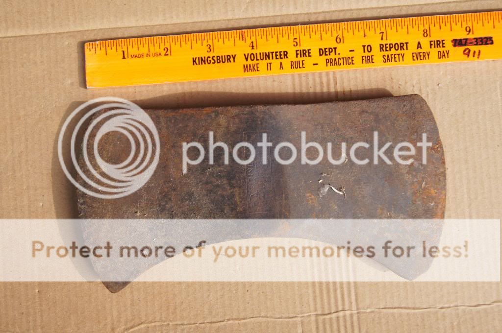

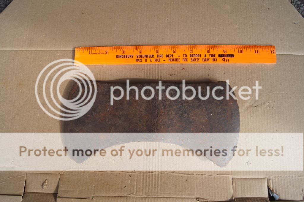

What do i have ? Looking for axe knowledge . . .
First thing I would clean would be that Firemans axe. Could be a Collins Ligetimus. Looks to be in great shape and crown and arm stamp would be a cherry on top.
The little DBL bit looks nice also. Looks like a cruiser, if it has a smaller eye size it is indeed a cruiser. Hope you find lots of stamps.

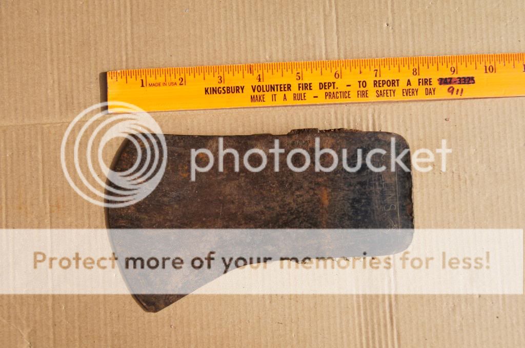

OK, The Flint edge is a nice stamp and the axe is in very good condition, the USFS stamp on the other side makes it better. Very nice.

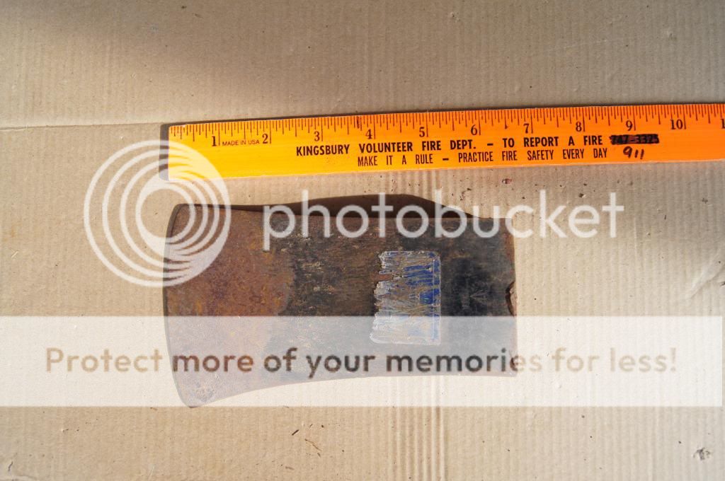

The Homstead is nothing much unless its a 2 1/2 pound cruiser. The eye size will be smaller than on that flint edge. I suspect that it is a cruiser but can't tell for sure from the picture. Cruisers are always sought after. Homestead is a Collins axe brand.It's alsoin very good condition.

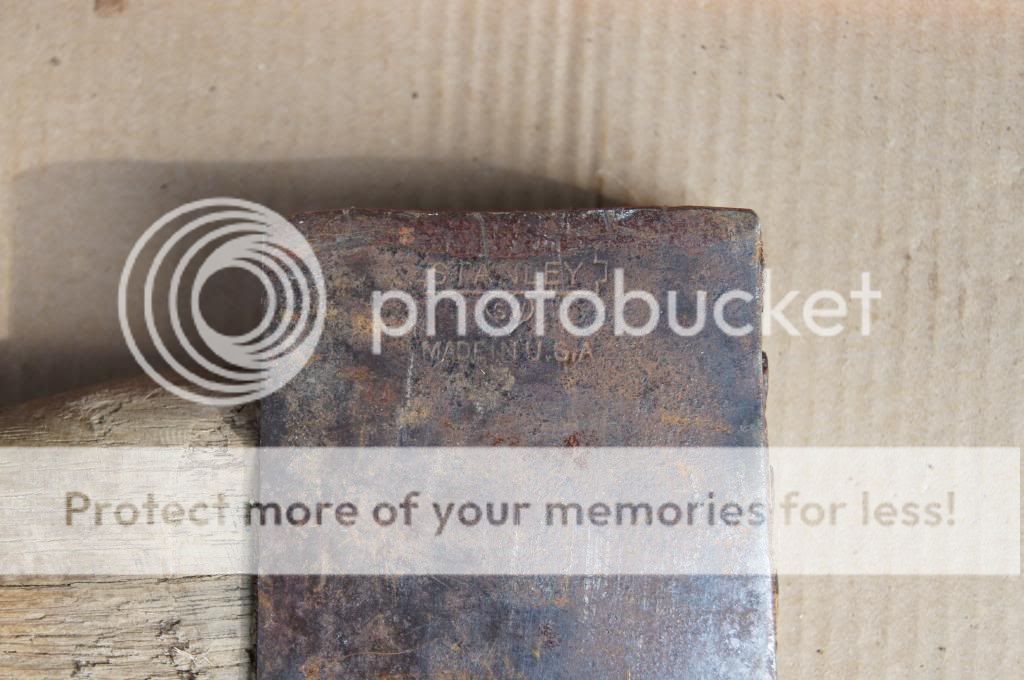

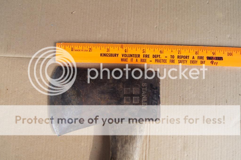

Stanly didn't make much in the way of full size axes that I know of. Yours looks like a Boys axe, or house axe. About 2 1/4 pounds if it is a boys axe. It is not in as good a condition as the first two, but not bad. The logo is called a Stanley Four Square. The stamp on the other side is called a Stanley Sweet Heart. The Sweet heart makes it much better than just a four square.

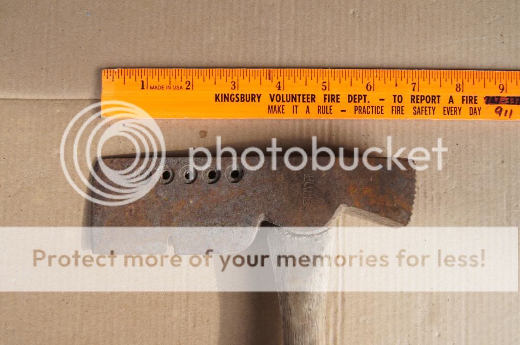

The little Plumb is a roofers axe. The holes are for cutters, tar paper, asphalt shingles. Might come in handy if you roof your house.

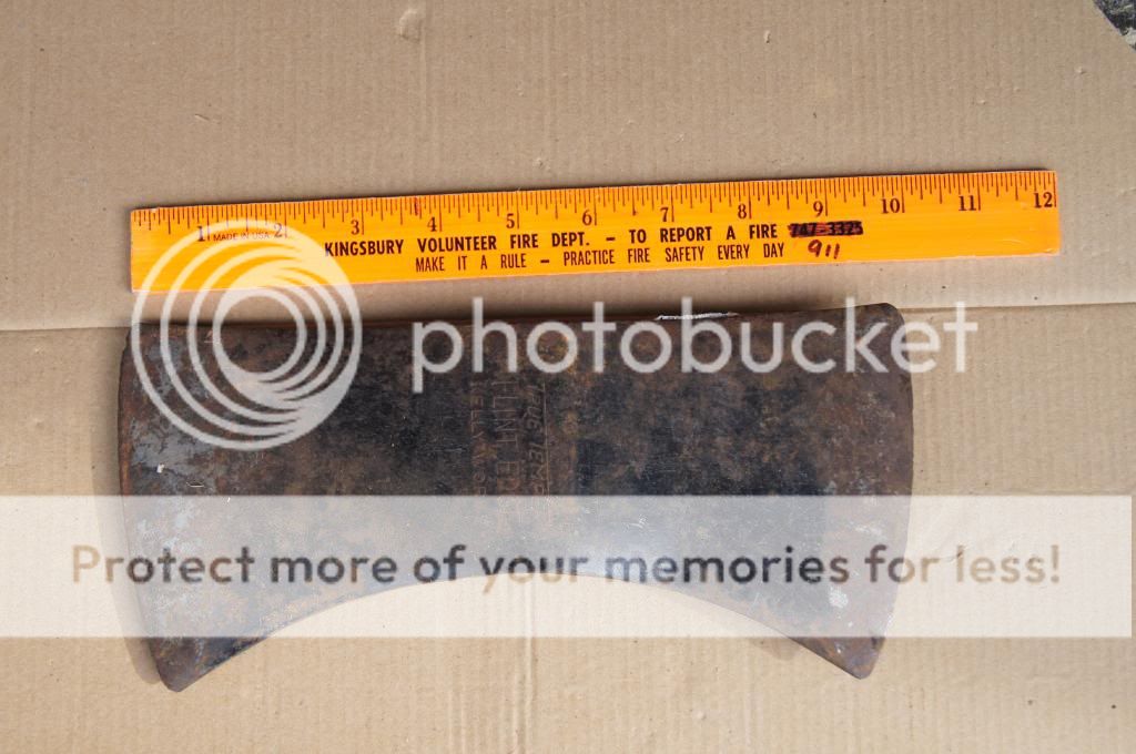

Can't make out the stamp on the DBL bit, TT Flint edge? Probably a good user.
Not familiar with the Keen Kutter. Maybe an earlier roofing axe for asphalt shingles? I am not positive.

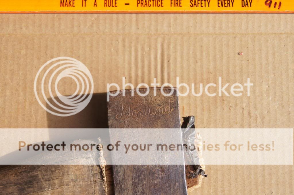

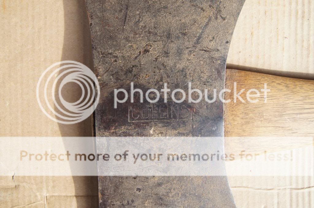

Oooh, a Collins Legitimus cruiser. Very Nice. The other axes are good too. Norlunds are in demand. Legitimus axes are earlier and better quality than later Collins.

My favorite so far is the Western pattern TT Kelly Works Flint Edge, USFS. There are probably quite a few of them around but that one looks like it has barely seen any use. I'd guess that's the original paint visible on the head. Flint Edge axes are great tools, and I'm a real double bit fan.

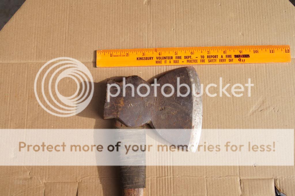

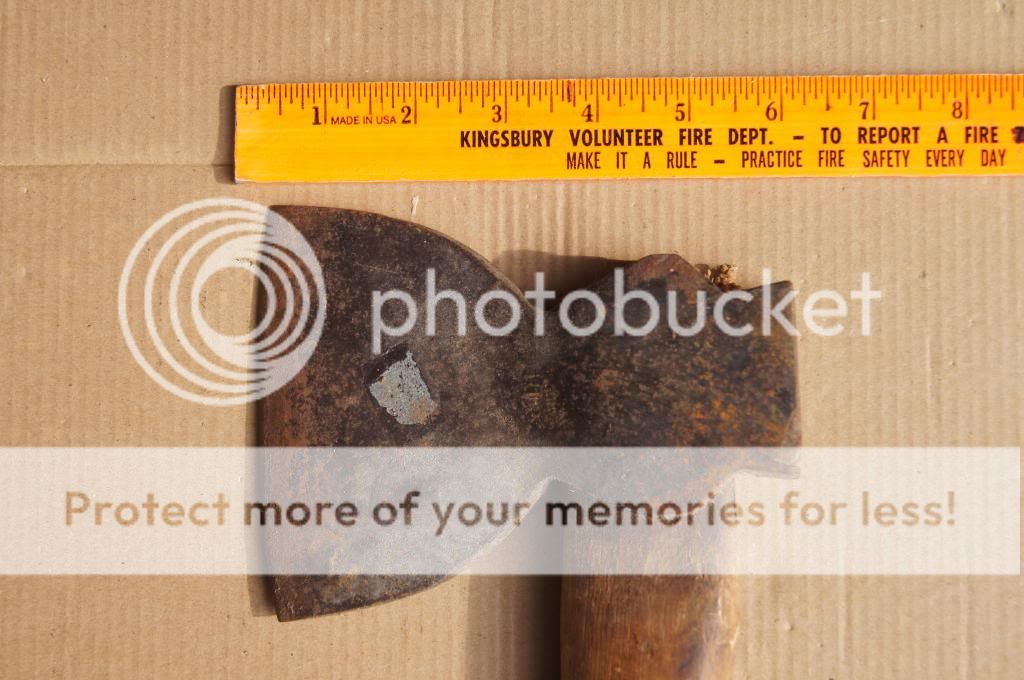

Whats the stamp on the hewing hatchet? Is that ATHA?
