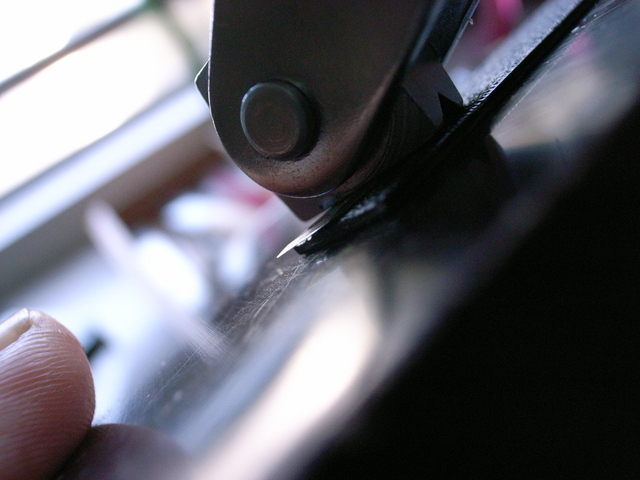

I did a kind of improvisation like this.
A snap-off knife blade chip on kydex sheat of adequate thickness.
They are fixed on a micarta plate with a clamp.
