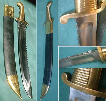

Traditionally, if we look back to the 19th century, large stout knives like these were issued as fascine/pioneer/Faschinenmesser knives to artillery and engineering units. During the early 20th century the US issued the Collins 1005 Engineers bolo, and the Springfield model 1904 medical bolo, as well as the 1909 and 1917 bolos. Virtually every major military power issued knives like these during the period. Their popularity with the military faded somewhat with the end of horse calvary and the rise of mechanized artillery.
So what do you do with a 7+inch knife? Primarilly, you can cut sticks, which can be used as raw materials for all sorts of camp projects.
Here is an example of the Russian 1837 sidearm:(note the photo shows a modern reproduction)
