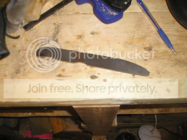

So, I finally got sick of not having a knife that fit me perfectly, one that just did have all the attributes that I want in a knife.
I want a spine thickness that could take some beating, a roughly 4" blade, full tang, scandi ground and carbon steel.
So, I did up the first drawing and did a cut out of what I wanted.
Now here it is after the first bit of grinding, now this was made from an old file, and I had to go slow because I dont have the equipment to heat treat, nor did I want too:D

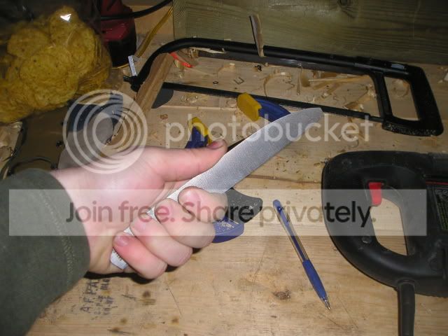

Now an in hand shot.

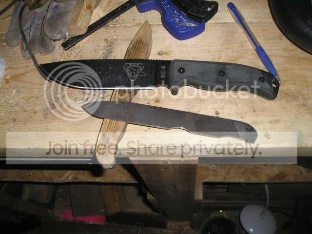

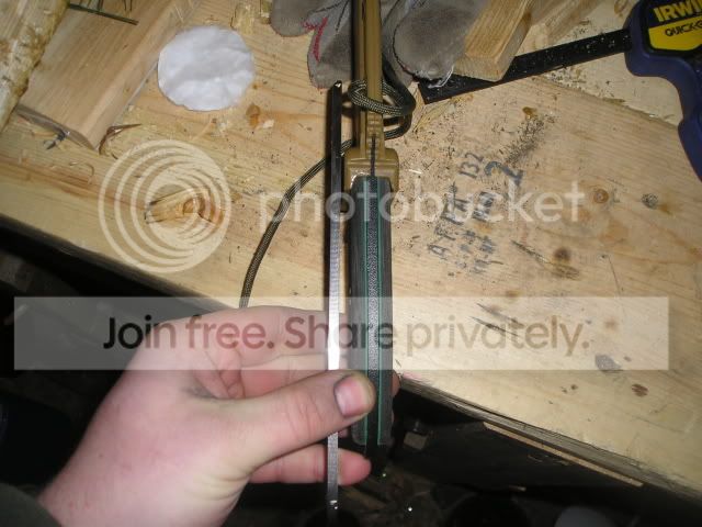

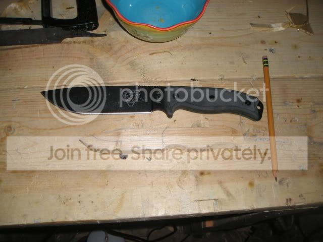

And now some comparison shots with the RC6.
So, I had originally wanted to make it a clip point, but as I was going, I thought it looked better with a drop point style. before I finished I had toyed with a tanto shape, and even a warncliff style, but this is what came out and I am very happy with it, I still need to put the scandi grind on, but its going to take some type as I dont have the right stuff, this all was done with a bench grinder and a desk mounted hand sander.

I think you have a great start. The only problem I see is you will NEVER stop at just one. Trust me, I know. ;)
Now that im looking at the picture the only thing I might do is make the finger coil more pronounced.
So far so good! I like the drop better than the clip.
Keep us up posted bro!

This is a file. Are you going to heat treat it down? Would a file be brittle otherwise? I dont know. Just enquiring.

looks like a good start! i would suggest grinding the teeth off of the file with your sander or bench grinder, to reduce drag in cuts. also, if you leave the teeth with a scandi grind you will file every cut you make...
you can mostly grind out the bevels on the bench grinder, and then flatten them out and true them up with the belt sander you have there. just take it slow and dunk after every pass or two to keep things cool.
about brittleness; i don't find a fully hardened file too brittle for a small knife. while shaping the handle of one with a fine tip (file blade-fully hardened) i accidentally dropped it point first into a concrete floor with no affect except for a small bit of dulling.

Thanks for the input guys, as to the file question, I think I might have too, or I could just not baton with it.
I have put the scandi grind on it now, it still needs some finishing touches, but overall its coming nice.
