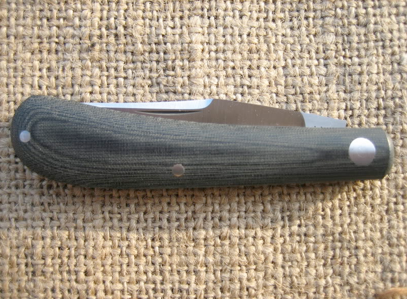

Basically, when you pick up a custom (particularly a slipjoint) what do you look for? Where do your eyes and fingers go first? Stuff like holding the knife to the light and seeing no gaps, blade centered, no lines on bolster to liner junction, bolster/cover junction clean and flush, flush in two/three positions. What else?
The reason I ask, I'm working on my third slipjoint. It's ready for heat treat, and I'm going to send it out on Monday. I'm really focusing on fit and finish on this knife, and I hope to post it here when it's done for you all to rip apart. I mean that in a good way; I want to be good at this, and "pats on the head" get people nowhere.
I hope you all can give me your opinion on what you consider to be a mark of quality in a custom slipjoint so that I can work them into this knife.
Edited to add: I'd like to hear from custom makers as well as collectors. Heck, I don't care who you are, if you have an opinion, share it.
Just by the way, pictures of the knife as it is now:
All I am sure of is that is one good looking knife! Nice work

That looks very nice!

The fit looks good, at least at this stage, as does the blade to handle ratio. How thick is the blade, though? It's hard to get a sense of scale, but the blade thickness is the one thing that looks a bit off to me. Also, I like sunk joints, either completely or partially. They're not a must, but they're certainly nice.
And what steel did you use?
Thanks so far guys. I have been emailing Mr. Hanson back and forth a little, and he had been more than accommodating. I live about 110 miles from Tony Bose, and hopefully I can get with him and watch him work some time soon. He said get with him some time after Blade was over, but I have been working too much lately. Hopefully soon though.
I'd like to convince a couple makers and collectors to let me send them the knife to have them look over and give me feedback on.
JA, the stock is 3/32" A2. I think I might switch to the next size down, 5/64" when I order steel again. That's about 15 thousands thinner, which should make them super slicers.
I wanted to make this knife with sunk joints, but it looked silly, so I went ahead and took the liners down a bit.
