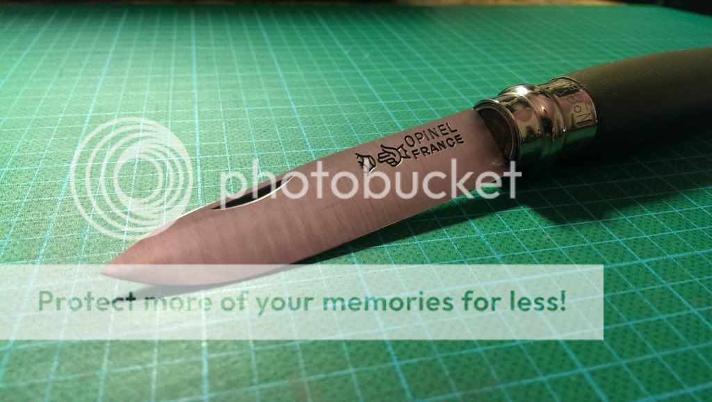

Just finished this older version #8 Carbon last night:

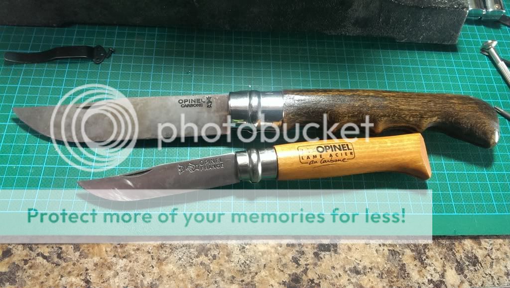

A love it or hate it weird #10 work in progress:

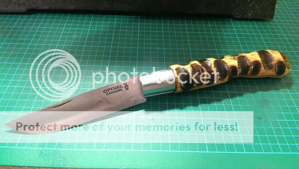

My well loved newer version #8 and tactical #12:
