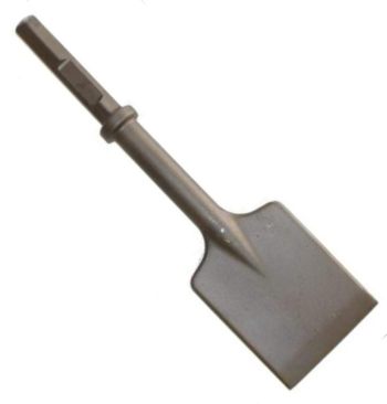

S-7 jackhammer bit. What do I win? :D
:eek: you got me sir! nice.
That had not occurred to me. I would REALLY like to see an s7 knife buy a top maker go head to head with an INFI knife.
S7 is a bit of a mystery to me. I haven't ever really seen anything that pushed it's durability (as a knife steel) to the limit
