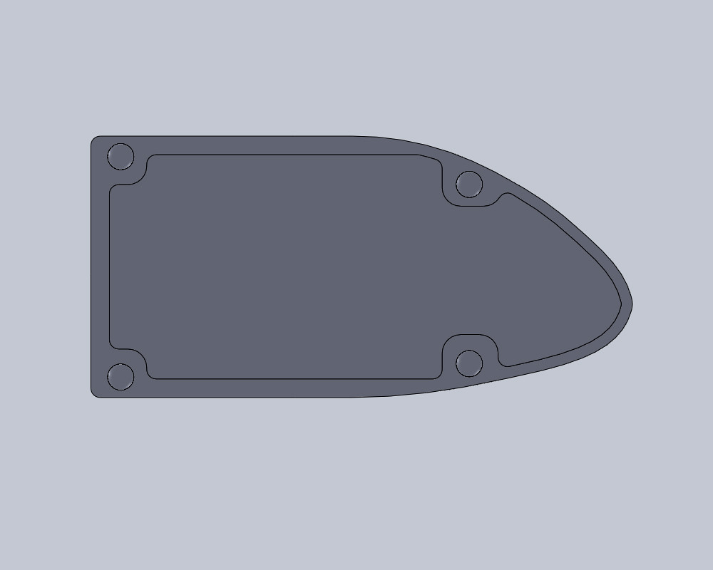

Hey guys, was sitting around thinking about how much I love the idea of carrying extra gear on my knife sheath but how much I hated my current options. I like the idea of a hard case, something that could be easily attached, and something that wasn't an altoids tin. Also the idea of something that could be made waterproof seemed pretty nice too. Problem is, there isn't anything like that on the market that will fit the BK2 sheath without a bunch of overhang or being really big and sticking out real far.

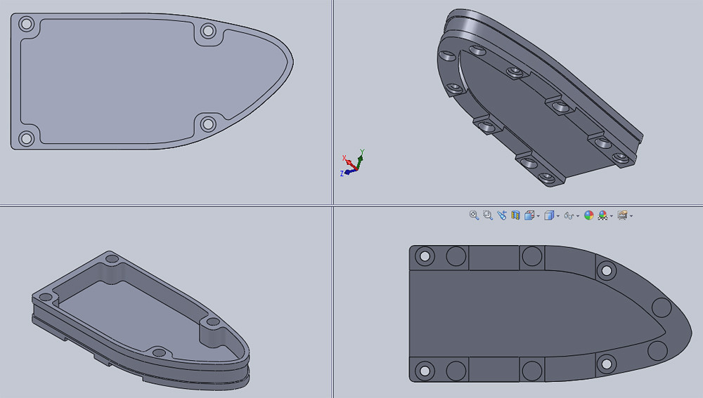

So, I got to thinking how nice it would be if there were a way to make something that would fit it perfectly, shaped the same, be low profile but still allow a decent bit of storage. And having access to a semi-decent 3D modeling program and a rather slow workday, I came up with this. Mind you I haven't drawn up the lid yet, mostly because I haven't figured out how I would like it to attach.
Here is the pic.
Now right now this is just an idea, and the measurements are really roughly guessed, but I think it would work out fairly well, still allow the usage of the strap holes, and would only need 4 chicago screws to attach it to the front of the sheath. So far it is 20mm thick, which is just a hair bigger than 3/4", and the lid would add a little more, but I think it would add quite a bit more space than an altoids tin.
All that being said, and everyone understanding that this is just an idea, what do you think? Please be gentle.

Definitely waterproof. I am thinking that if I made a lid that had a cutout that fit into the main compartment, by like say a couple of millimeters, then plasti-coted it, that would make it waterproof enough. Then, say from the sides a nylon strap with some simple velcro on it to secure it in place. Maybe some nubs to fit down in the screw holes where the screws would go for the chicago screws to attach it to the sheath.

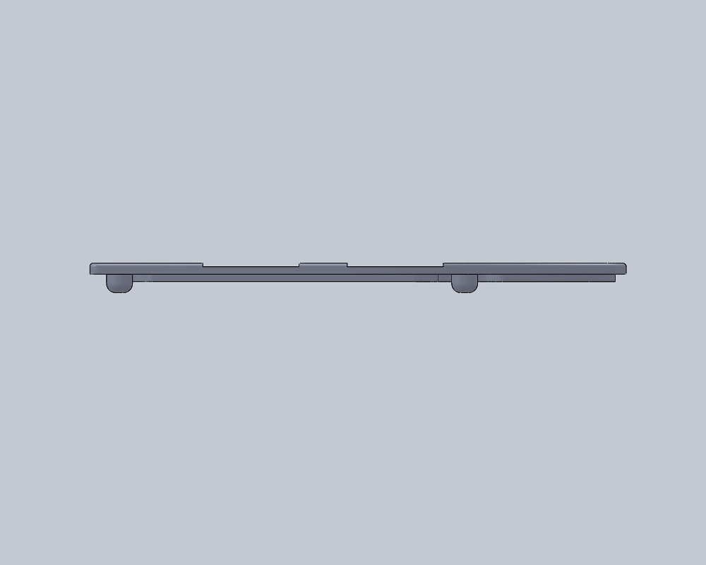

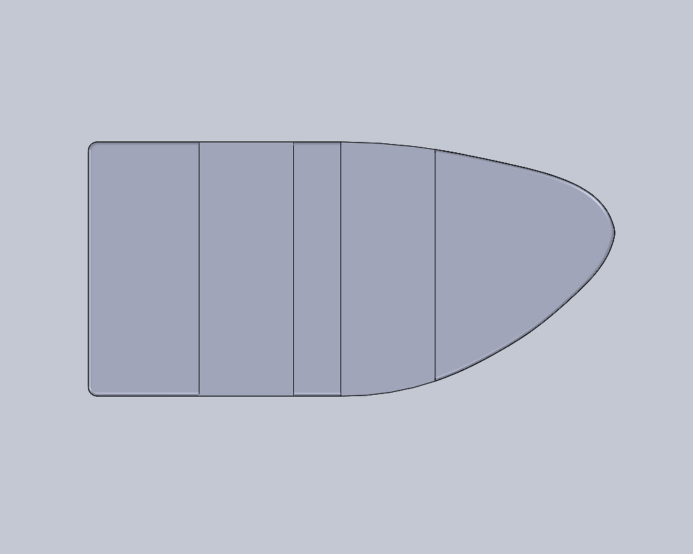

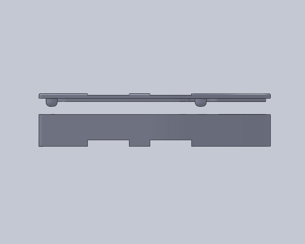

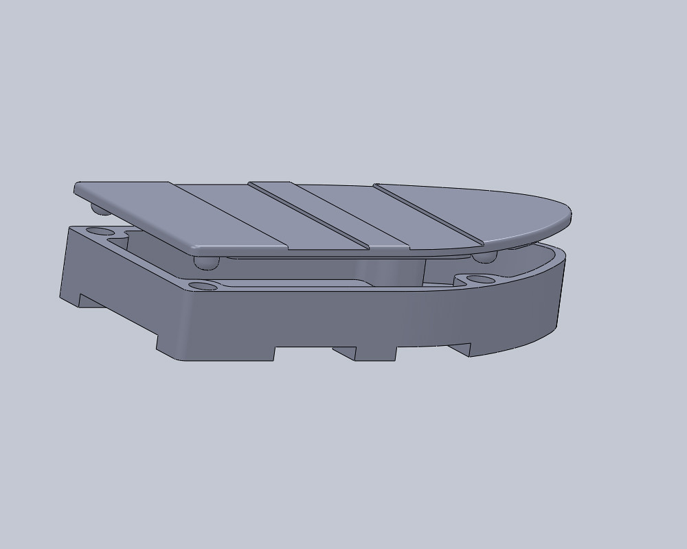

Okay, few tweaks, and an idea for the lid. I like the idea of a small gasket, that would work well I think. To secure, wrap two pieces of 1" nylon webbing around, and where the ends would meet on top have either snaps or velcro or some quick release clips.
Pics.
So, straps you would use for sheath on your leg would go on like normal. Then, on top of that, small straps for the box and lid. Then bolt on box using four chicago screws in the four holes. This will hold on the straps used to hold down the lid, and when you undo them to remove the lid, would still keep them in place to wrap over top of the lid when back in place. If using quick release buckle thingy the notches in the top could be left out completely.
For the inside of the lid I could make a recessed area to glue in a match striker (or double sided tape, whatev) or leave as is so a piece of sandpaper could be glued on for field sharpening.
I like that, a good gasket on a good solid lid and a couple of compression straps would be a great idea for securing I think.
