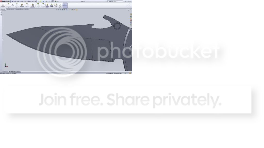

So for one of my engineering classes this past quarter, our final project was to make a CAD model of something with attention given to the manufacturing aspect. Naturally, I decided to do a knife! It has some rough edges and missing final touches, but I only had 3 weeks to make it in a 20 unit quarter, and a lot of the work went into internal stuff like ball bearings and lightening cavities. Anyway, thought you guys would get a kick out of it. A lot of the features you can see: lowrider reversible clip that can be removed to use the lanyard hole, hollow grind, wave deployment/bottle opener, etc. I mapped the ergos to fit my hand, but left plenty of room for larger hands. Also, it looks like an axis lock, but it's actually a different kind of lock I made up for the knife.
Couple of CAD models and quick renderings:

but I don't really think the wave feature will work fine, due to the opposite side of it that I consider the bottle opener, it's gonna catch your pocket, and rip it :))
Don't wanna wear a sexy pant in a tactical situation tho
What do you think about making the longish protruding part shorter? It'll still work as a bottle opener and wave and it won't stick out as much.

Thanks, everyone! After taking a closer look, I think a shorter prong really would be better. The grip on the knife is pretty large so the thumb ramp doesn't have to be too big, and having a shorter hook would give the knife more clearance from the bottle when using the bottle opener. Maybe something like this?
I also added an indent in the handle for the scale to fit into, since it and the clip were protruding a little too much.

Perhaps you could analyze the area of the thumbstud. Imagine the hole on the blade where you insert the thumbstud, depending on the type of method you insert it then the prong may be weakened by the hole. If the thumbstud is the pushed in type then there is a real possibility of cracking the blade.

I agree with Brets-ftw, I have never had a problem on my Vantage(or any other deep carry waved knives) doing exactly what he did, with or without the lanyard. Maybe you could slightly alter the clip design and add the lanyard hole to the clip.
Other than that, the one thing I might be inclined to change is the thumbstud. I just generally don't like them, and I think the cutout for the wave would serve well enough as an opening hole anyways.

I like the design overall. If it were mine to tweek I would remove the bottle opener, and shrink the Wave hook, you don't need that much. I would also smooth out the handle some reducing the magnitude of the finger indents and protrusions. I like the hooked pommel, more knives need that.
One very minor thing, I notice almost all of the lines of this knife are curves, except one. On the spine of the handle from the midpoint where it slopes down to the pomel is a straight line. I think that's visually jarring. I would change it to a gentle curve, it would probably improve ergos too.
