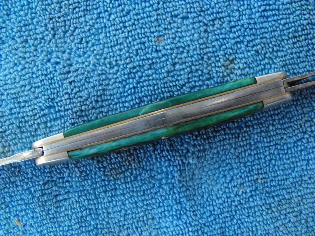

I haven't as of yet had a play with a three springed Whittler, but Just what does the wedge do?...and what is the actual theory behind the wedge?, and what is wrong ( or the difference ) between the straight springs, and the wedged springs?
I hope this is keeping within the op's topic.

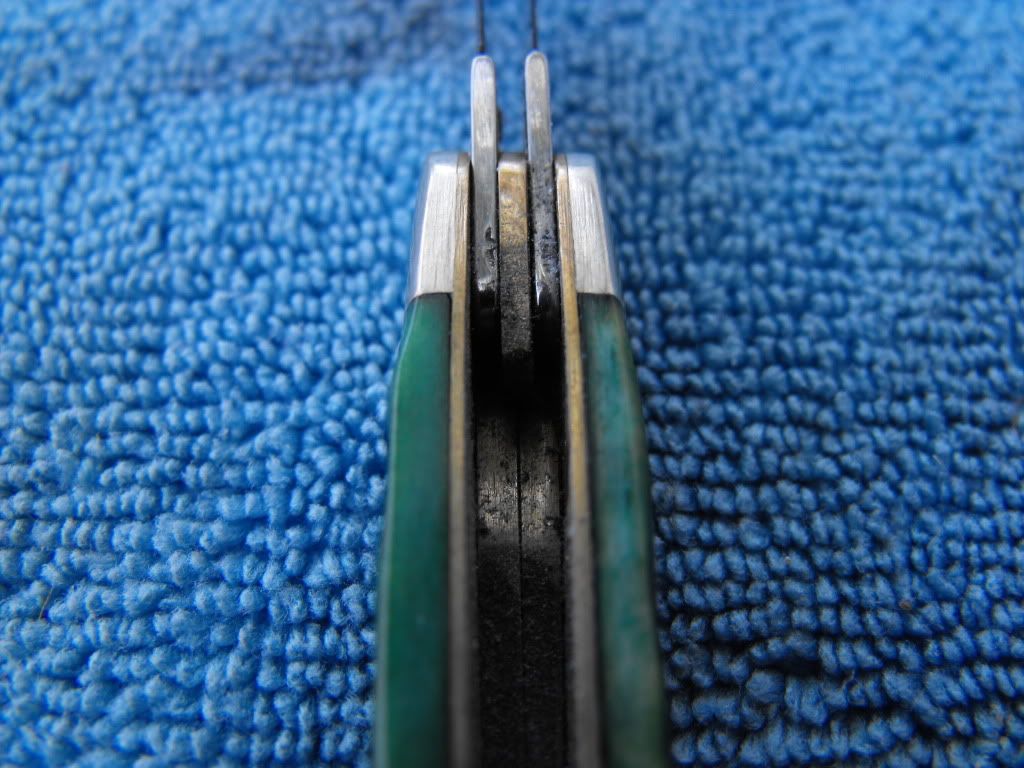

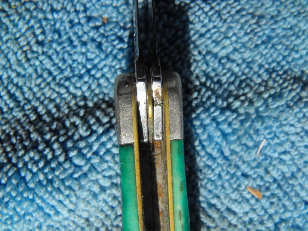

The wedge seperates the two springs at the secondary end, spreading them apart to provide room between the secondary blades for the main blade to fit into. Parallel springs are sometimes used, with a catch bit to provide the spacing between the secondaries. I also have one that has tapered springs with a catch bit.
Split back
Parallel Spring
Tapered springs

Thank you for that fantastic expalanation ( with the pics :thumbup: )..its taught me a hell of a lot my friend..thank you.
Happy to help. My personal opinion is the split backspring shows the most skill in construction, followed by the tapered spring. The straight parallel spring set up is simple and effective, but it has always struck me as "taking the easy way out". It also tends to leave the main blade thicker than I care for. I prefer my whittling blades thin.
