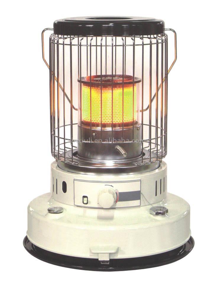

Google translate converts "Kerosene" in english to "kerosine" in Dutch.
I don't know if that's right, Petroloum you say ?
We used to also call it "Coal Oil"
It's clear and colourless, thinner than oil and thicker than water with a slight oily feel.
It's widely available here in farm supply and hardware stores as lantern fuel, portable heater fuel, paint solvent.
"K1" is aircraft jet engine fuel.
We can buy it in 1 Litre, 4 litre, 20 litre and 200 Litre containers.
quart, gallon, 5 gallon pail, 55 gallon drum
When I buy "lamp oil" here in Canada it's coloured and perfumed so it looks pretty in these lamps
Who knows what those additives are and it's probably best to skip those.
