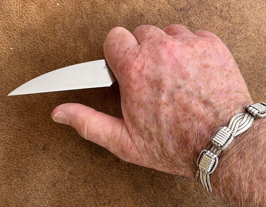

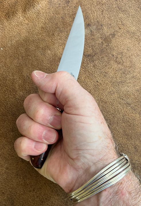

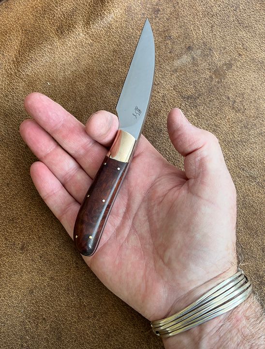

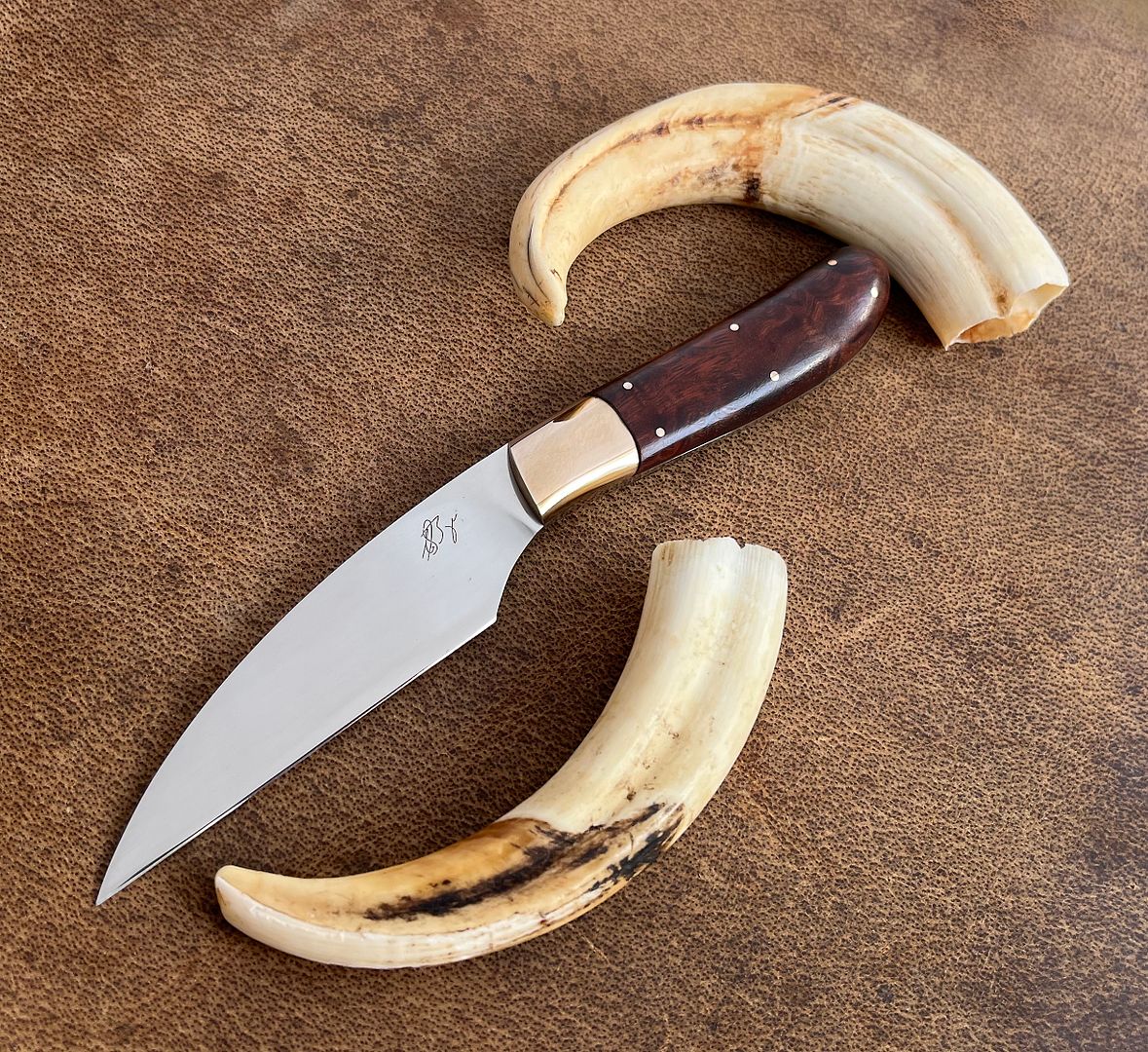

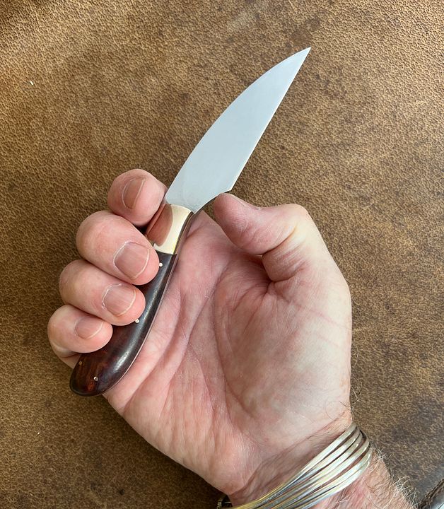

If it helps at all, have a small fixed blade Swayback bought some years ago in South Africa from Trevor Burger.
The handle has a good thickness to it, very comfy in the hand, and not that far off the mark for a folder of the same size.
It is nice to use, to say the least, and comes up particularly well reverse-grip when slicing biltong (your kinda jerky) and fruit...

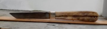

On the other hand here are two fixed blades with very nicely shaped "sway forward" handles. One a cheapo that I recovered and the beautiful maple straight edge is from G.L. Drew.
You would think by looking at them that the G.L. drew would aggressively dig in at the tip, but the blade edge actually sits back when holding the knife, like the Lambsfoot. On the Schrade with black scales the tip sits forward a bit more when you hold it.
So my conclusion was that it's not just the handle shape, but the blade shape as well. It's about the edge shape and where the tip of the knife ends up when you hold it comfortably in hand. That and it's intended use. The swayback is very comfortable in hand but I do t think you can use it on any fixed blade, it would have to be a well thought out blade to go with it.
