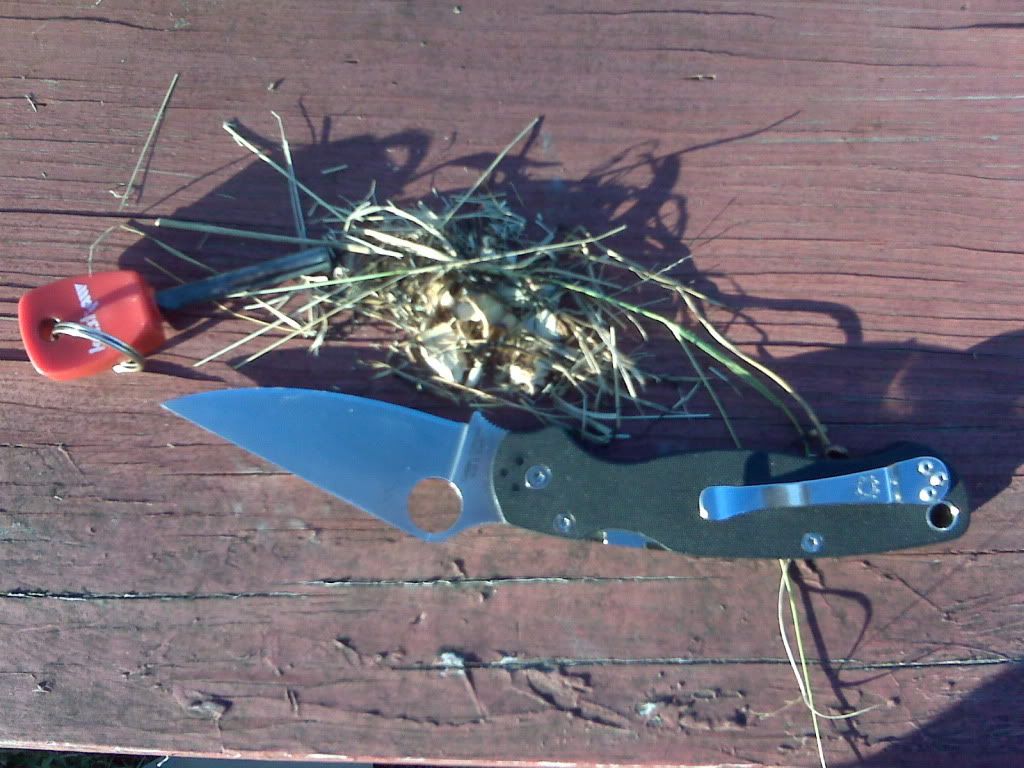

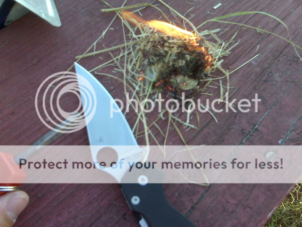

The Paramilitary 2 spine works flawlessly :thumbup:
I don't think I'd ever use the blade edge unless I absolutely had to. When purchasing knives I like to check if the spine is squared away for this very reason. Pics and an example :D
