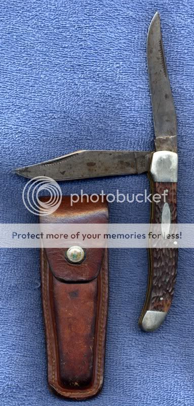

To demonstrate, here is the hunting knife (Camillus) my father used every season for 30+ years:
