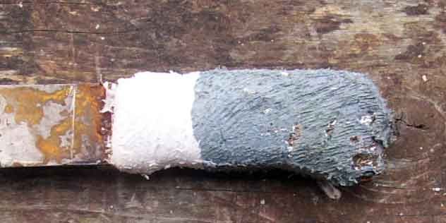

Bag handle :
It only takes a few minutes for the bags to melt, the foil sticks to them. I rasped it to shape. It leaves a very aggressive texture which should wear smooth in use. It seems solid through a few minutes of chopping. However the first inch or so near the choil didn't get completely formed because I was concerned about the blade overheating. If this breaks off I'll redo it a bit better and check again.

Cliff,
Your bag handle actually looks alot better than the one I saw here. Must be those good Canadian Bags. Good job. Mac
It is actually pretty easy to work with a file, you could probably polish it if you wanted with a buffer / sandpaper. You could even work some kind of pattern using the different color bags, the above was accidental in that respect. The gnarly bits on the end are bits of foil, they can obviously be removed if desired. If you have another knife you can also carve it to shape, or just grind it on a rock. I would recommend wrapping a much larger handle which gives you room to work it to shape. If you heat it too much it tends to melt and will run out of the foil or catch fire if you lay it in the coals so a decent pair of gloves is useful to keep checking it. It is actually fairly hard once set, you could probably "cast" a spear tip from it and various other tools. Interesting media.
