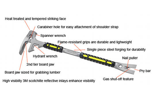

Would like to see something similar to the Winkler II Emergency Response Tool which could take the place of a number of specialized tools on a construction jobsite. The CPK tool could incorporate a hammer with a milled face, prybar w/ nail puller, gas and water meter shutoff cutouts as well as support for three standard wrenches (3/8 1/2 3/4) with the possibility of a fourth (5/8). So instead of carrying multiple tools in a belt/bag/box, one could simply hang a single tool within a hammer loop. No need for a glass breaker. Hammer face could be flared to increase surface area (off-angle strikes often result in time lost to pulling out bent nails and renailing). Imperial and metric markings along the handle to perform impromptu measurements. A sharpened edge for cutting and light chopping and a secondary scraping edge to preserve the cutting and prybar edges. Not meant to supplant basic, specialized tools (e.g. framing hammer) and designed primarily for general pickup work (intermittent hard use over short(er) durations). Replaceable micarta or rubber scales at one end to handle shock and vibration under heavier hammer blows. Else, large jimping along the sides to improve purchase. Essentially, a construction multitool to serve as a jack-of-many-trades, but perhaps the master of none (save for possibly the prybar/nail puller).
funny, I've pitched the idea of a simple multi tool to Nathan in the past, and he seemed to dig the idea. When I clear through the other projects on my table, I'll start drawing something up. I think I'll give it a 'dad' theme
That would be fantastic. Something a dad would use in and around the house is pretty much what a construction contractor would use on site for odds and ends work.
I used a fatmax "fubar" during the demo phase of the last home reno I did. Very helpful and handy for quick jobs.
If there's a cpk take on a fubar, mark me down for 2. ;)
do you keep that on your key ring?
Lol, no. Would be entertaining tho.
Are we talking about a keyring tool? I was thinking something more substantial.
The FatMax FuBar looks interesting. A bit long for hammer loop carry. The WK II ERT is about nine inches in length. What stands out to me on the FuBar is the flared strike face and pry tail opening to accomodate gas and possibly water shutoff valves. I fail to see the utility of the board jaw, however. @coiledwire: Did you find the board jaw useful? I might shorten everything down to twelve inches max and turn the board jaw into a sharpened edge. I suppose it would be an axe with a hammer end at that point. For a CPK tool, perhaps add two holes to the handle to thread string/rope/paracord through for a quick field handle. Offer grips secured using the same holes.
