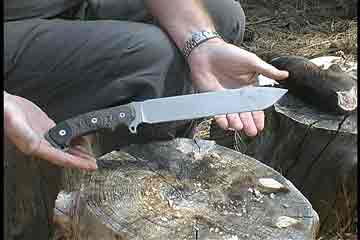

Here are some photos of the same basic designed knife.
Now in the first photo notice that along the lower cutting edge, just before the handle guard, how the cutting edge stops?
Thats where the knife maker made what i think is a flaw to his design.
http://www.knifeoutlet.com/shop/10Expand.asp?ProductCode=DAKW3
Do you see how if you tried to do what they call a "push-cut" that the material you are cutting would slide nice all the way up the blade until it got to the guard area, where it would pop up into the part in front of the the guard where the maker grinded away the edge?
Thats where it will always snag.
Every time you try to make a good long cut and use the full length of the blade, it will get to that point and snag.
Now lets look at a far better design on the same type of knife
http://www.knifeoutlet.com/shop/10Expand.asp?ProductCode=AK10
Here we dont see that little missing section along the lower cutting edge just in front of the guard.
notice how the cutting edge flows right up to the guard?
This means that you can really cut stuff all the way up the length of the blade.'
You dont have to stop the cut early.
so magneto, what I would do to that first knife would be to take it over to my grinder and grind the cutting edge so that it flows up to match the other part just in front of the guard.
You would need to re-grind a lot of steel, but in the end you would have a blade that looks just like the knife in the 2nd photo. I would take off about a 1/4 inch of steel running the whole length of the cutting edge.
Now go back and look at the two knives in the photos.
they are almost the same knife, except the top knife has that darn "dropped edge" that will always be snagging stuff.
get rid of the dropped edge and you got the same knife.
any questions?
"Snagging" is simply not an issue for any reasonable use of a knife even in the wildest survival scenario...
Im saying that not only has the "dropped edge" no reason to be on a survival knife, I also saying that it's a flaw on most knives made today!
The cut-out makes it always going to snag.
If you try to make a cut using the full length of the blade, it will snag 100% of the time.
The flaw is that sure to cause trouble that the owner of the knife will start to actually change the way he would like to cut something, to keep the cut-out clear of the material.
This means that no matter the fact that you own a blade with a 4 or 5 or 6 inch sharpened edge, you really only dare use the first few little inches.
Well I happen to think that if I paied for a 6 inch knife blade, then I should be able to use the full length of the blade hard without it snagging all the time!
A simple design change, and getting rid of the dropped edge, will allow you to use the full length of the knife thats sharpened.
You can start a cut at the tip of the knife, work the material all the way to the guard, where it will come to a stop, and then start a "pull-cut" with no need to reposition.
You can use every part of the knife edge to cut with.
Thats the way a knife should work by the way.
What are you cutting that makes use of the full length of the blade? Are you dressing out large whales and dealing with several feet of blubber that you must slice through?
I'm sorry but I've field dressed plenty of deer - and I've yet to "snag" my blade. In fact, except for splitting the pelvis, any good quality blade at least two inches in length is sufficient to dress out large game.
And please don't suggest I should be concerned with stabbing wild game with my knife - that's what a wooden spear hardened over the fire is for.
A good survival knife needs to be of a design that will allow the user the chance to turn it into a spear point in the stabbing of many types of wild game.
If you look at the many knives that Im talking about that have the dropped edge design, then you should be able to see that there is a real built-in design flaw to it as well.
The dropped edge will snag 100% of the time if given the chance.
The only way around this flaw is to not allow the dropped edge to be close to the things you are cutting.
And that means you dont get to make full-length cuts.
Well, Im the type of guy who thinks that if I own a knife with a 6 inch blade, that I better be able to use the whole darn thing!
I paied for the whole edge anyway, I want to have the chance to use it!
It's a simple design change to make on a knife.
You just allow the cutting edge to flow right into the flat ricaso area....thats it.http://www.coldsteel.com/60ss.html
This small change to a knife edge will get rid of the never ending frustration of snagging/reposition/snag again/reposition again, etc,etc,

Now a far better design is to flow the cutting edge into a flat ricaso area in front of the guard.http://www.coldsteel.com/60ss.html
This would still allow a place to put a finger and choke-up on the blade.
And most importantly, it would not harm the full-length cutting stroke at all...
If I may borrow the Fehrman pic posted by Fonly
Geez, that's a nice knife. Mine has the black crinkle coat and for the record, the choil does not snag.
I'm done here. I'm off to not-surviving with my folder and other flawed fixed blades ;)
The part of the design that i really like on this blade is the placement of the strap hole near the top end of the handle , and not near the butt end of the knife.
I like it near the top as shown here because it allows for a leather strap to drape down and under the hand. Thus the hand is supported better while doing heavy chopping.
I have always felt that when the leather support strap come up from underneath the palm of the hand that it's near worthless in helping the hand hold onto the blade while chopping.
With this placement in the photo, you can even rest the fingers a little and lighten up how much force you use to grip the handle and the strap's position will hold the hand to the handle automaticaly.
