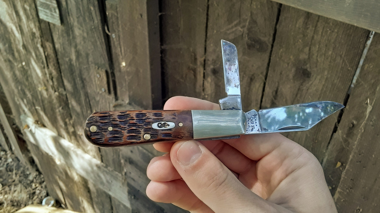

This is an example of what isn't a " good traditional Barlow ".The shield though unconventional isn't really my problem, it's the color. I don't like it in general, but especially not on a Barlow.

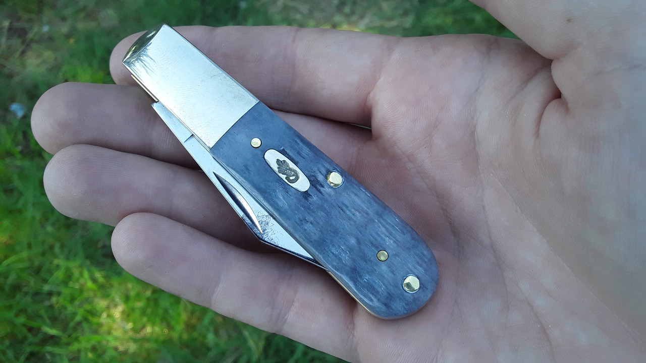

And this is my attempt to make a good traditional Barlow out of it.
Thank you.That's a very good attempt lol. What did you use to dye the scales?
Thanks, I'll have to try that. I have several grey bone Case knives and while I actually do like the color on most of them, I agree with you that it doesn't look quite right on a Barlow.Thank you.
I dyed it for 10 minutes with RIT chocolate brown, vigorously polished it with some green compound on a rag, lightly torched it all over, then another dye bath for 5 minutes, and a light final hand polishing.
I think I've settled on calling this hot chocolate bone.
Keep in mind that you can get spots on carbon steel blades and decent corrosion on the tangs because RIT liquid calls for some salt to be ( I tried not using salt, it worked on some but the Case knives definitely needed it )Thanks, I'll have to try that. I have several grey bone Case knives and while I actually do like the color on most of them, I agree with you that it doesn't look quite right on a Barlow.
Thanks for the advice. I'll probably practice on a lesser pattern before I commit to ruining a BarlowKeep in mind that you can get spots on carbon steel blades and decent corrosion on the tangs because RIT liquid calls for some salt to be ( I tried not using salt, it worked on some but the Case knives definitely needed it )
generally you want the knife to cool before rinsing to avoid a temperature shock that could crack the bone, but I wanted to rinse the dye off ASAP to avoid the corrosion so I quickly dunked it in some less hot water to cool it down a little before rinsing / scrubbing in hot faucet water then blowing out with the air compressor.
You just don't want to go directly from hot to cold.
There's a couple threads on dying knives if you wanna search for them.
