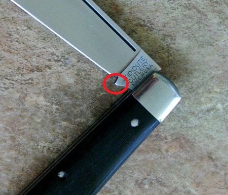

i guess thats what happens like in dr.scott's above post where he mentioned the point on his barlow and bullnose rested a tiny bit above the handle and it would catch his hand if he ran his hand over it. my question is, how can a company release a knife in this kind of condition? i'm not trying to say anything bad about the company but if it catches a persons hand ever so slightly or snags on a piece of clothing, that would bother me.
if you're sold a knife with the point a hair above the handle, can it be fixed? also, i'm still trying to figure out what a kick is or where it's located.
