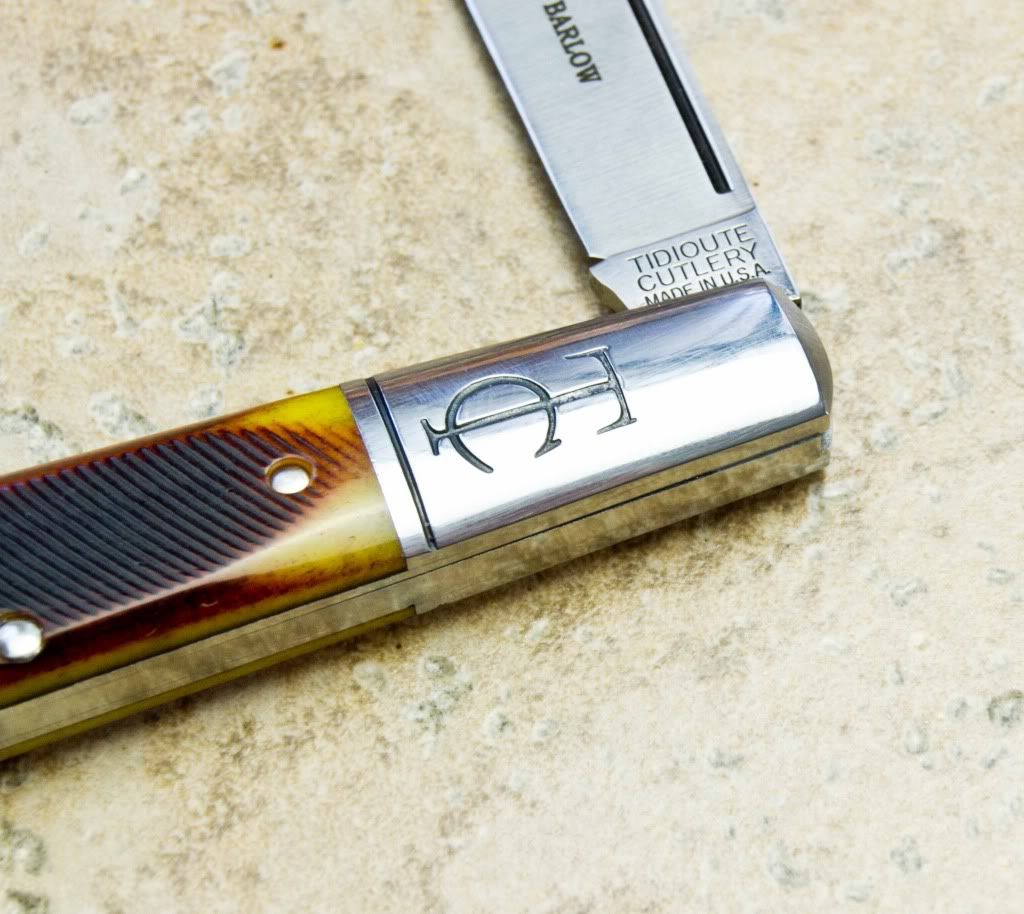

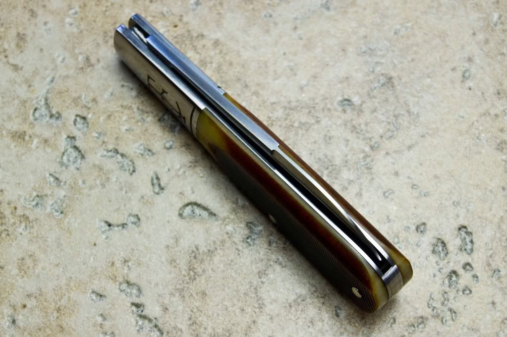

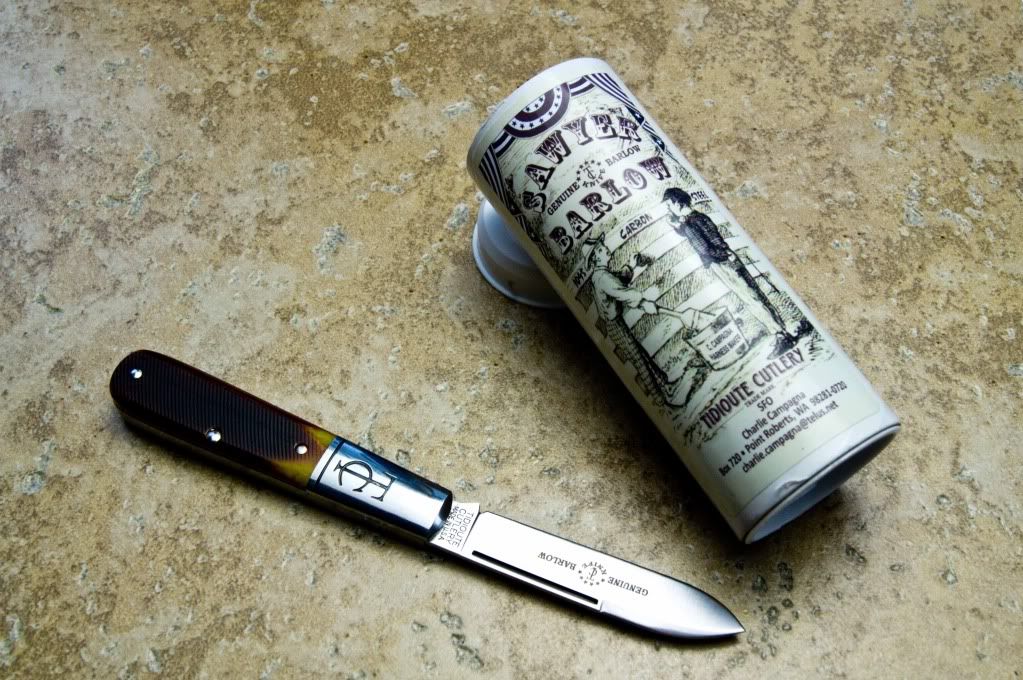

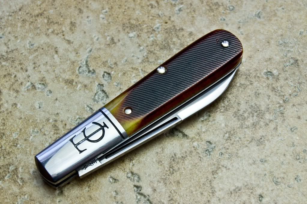

When Charlie first posted pictures and specs for the Tidioute Cutlery SFO Barlows I was impressed with what I thought were "proper proportions".
Fast forward to yesterday and the Sawyer Single blade Barlow I purchased from Charlie arrived.
I think the knife qualifies as a "good, traditional Barlow" without a doubt!
Here is my mini review of the knife along with some pictures.
Over all design, A+
Fit and finish, B+ I am impressed with the fit and finish of this knife but there are a few tiny details that could make a big difference. I think perhaps GEC could do a bit better finish job on the inside backspring and the radius-ed portion of the tang that runs up to the kick. The back spring sits a tad high at half-stop and ever so slightly at open position. The bolster stamp and threading are crisp, even. Minor marks around one the most rear pin on the mark side(possibly from spinning operation).
Covers, A+ The bone covers have a very nice color with lighter underlying, almost yellow color. The saw-cut is spot on. Very nicely blended at the bolsters with a nice chamfer along the edges.
Blade grind, swedges, sharpness and finish, A- The thinness of the grind is spot on, swedges are even, the brushed finish is just a tad heavy handed.
Action, A nice smooth positive half-stop, medium pull without being a nail breaker, blade does not hit backspring, no blade wobble open or closed.
In short this is a very impressive , well thought out knife with great lines! Job well done.
Glad you like it Ken! Thanks for the professional review! Your hand and eye on the knife carries a lot of weight.
It is gratifying that the knife gets a passing grade in your estimate.
