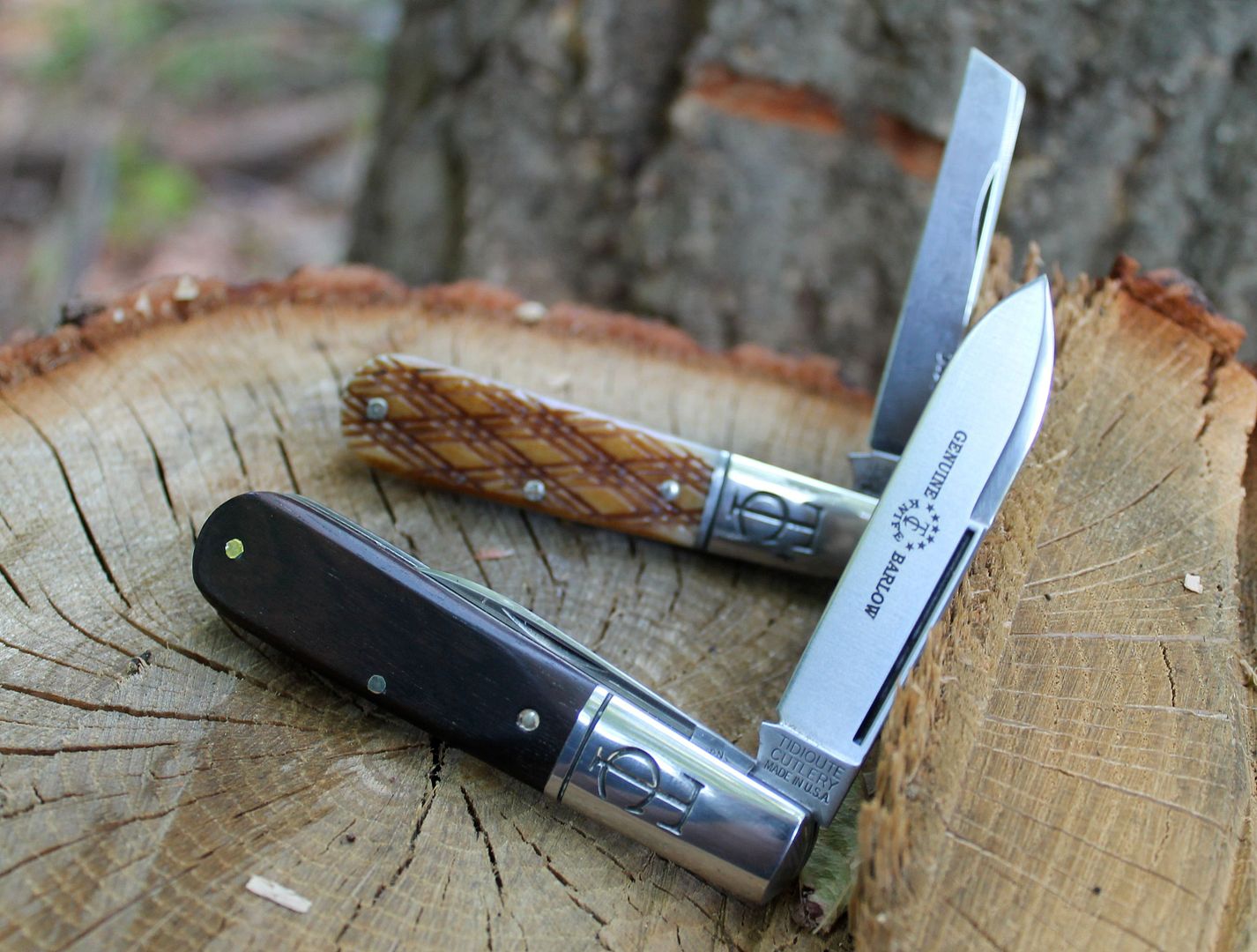

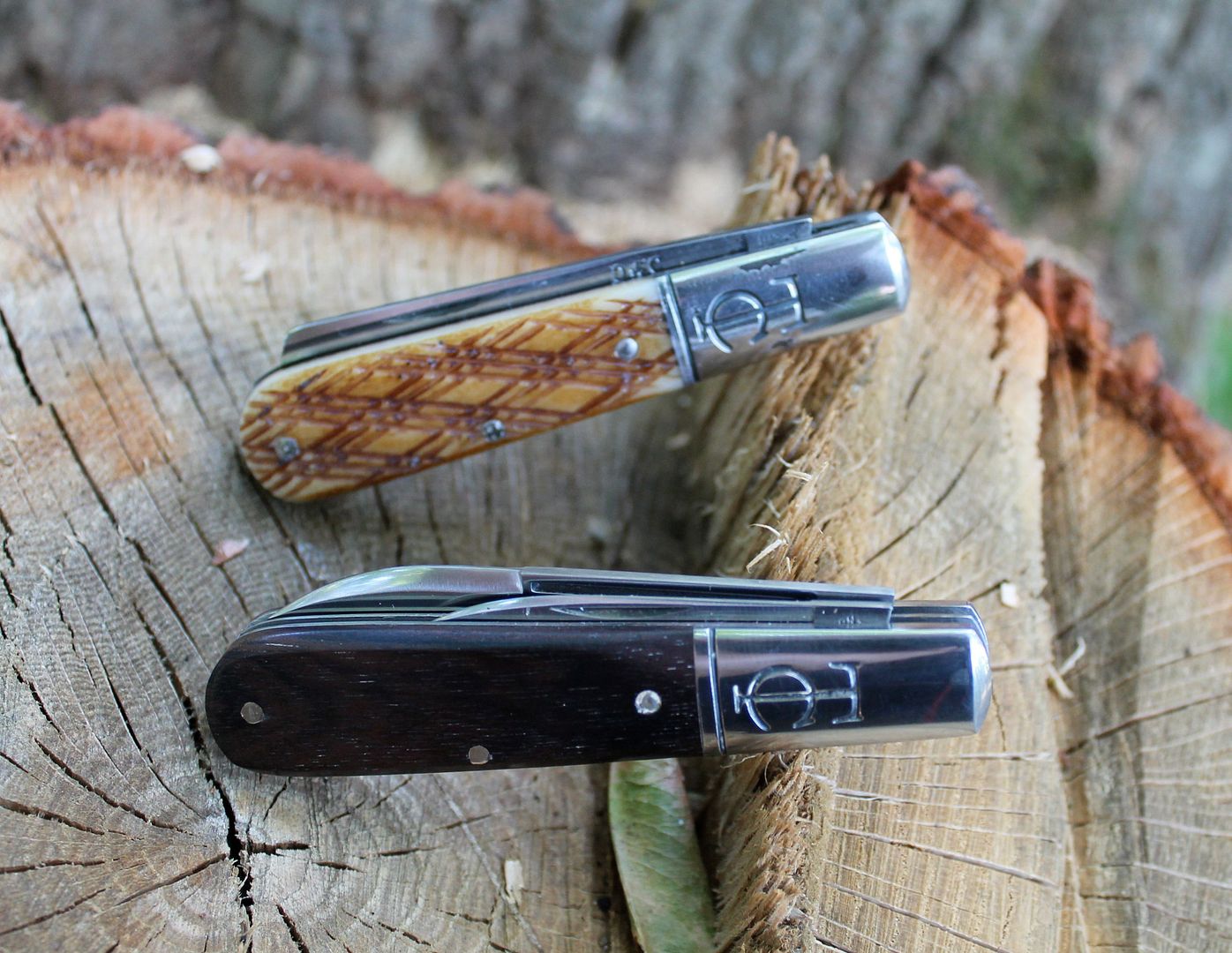

Tony knows I am a Barlow Boy, and engineered those matching knives with Kerry, completely unbeknownst to me!!
I feel honored, if unworthy to have custody!!

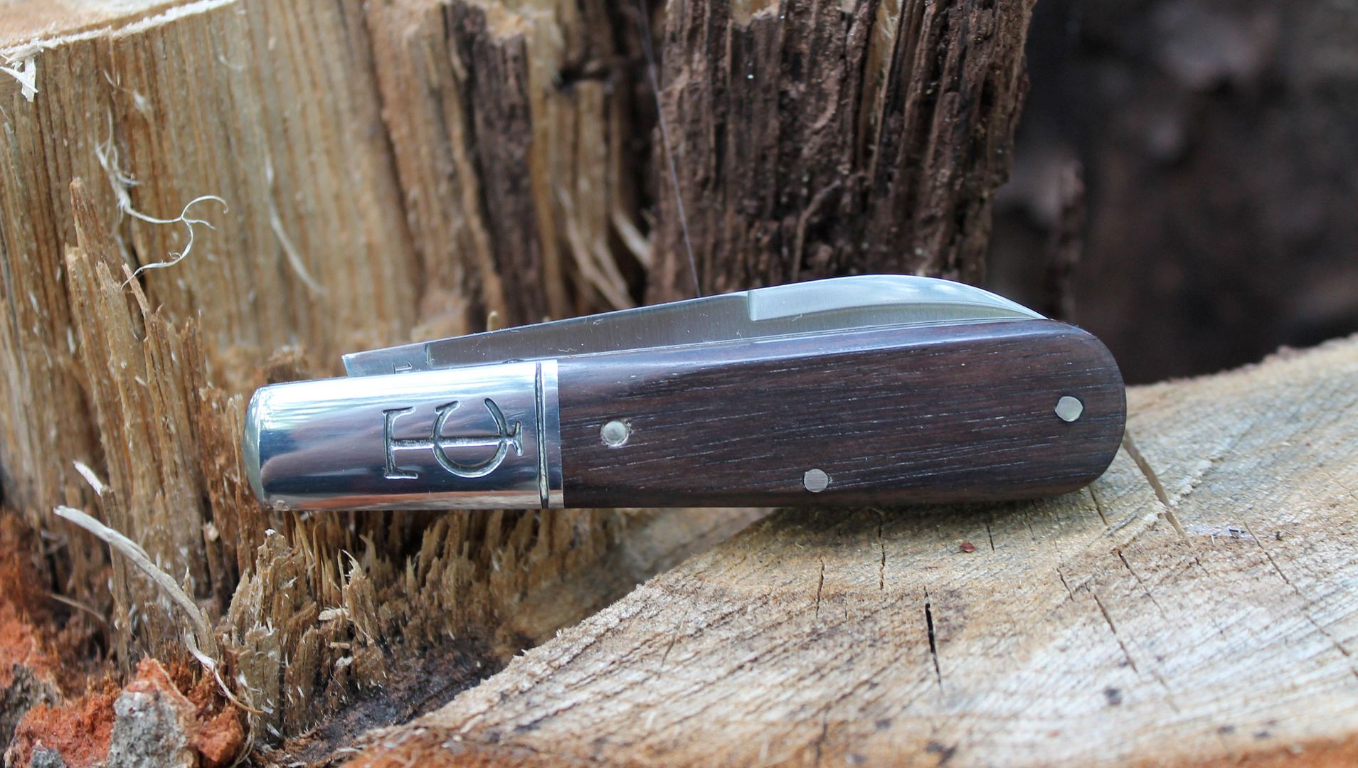

Thanks to Charlie I was able to add one of my holy grail Barlow's. First year 2 blade TC with Macassar Ebony handles. I love the shape of the spear blade with that swedge, such a classy vintage look.
Charlie and I did some trading involving a very rare old Barlow and this rare new Barlow, I am very pleased with the Barlow I received and I hope Charlie will be with the one he is getting.

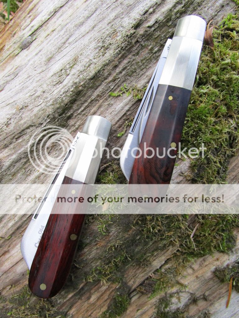

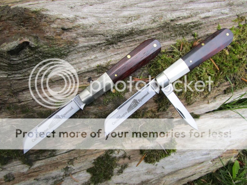

I like the way the WW boys "nipped" the corners of the bone in the old way, rather than tapering them. Bill at GEC told me they used to finish bolsters horizontally on the wheels, hence the "nip". When they do it the "modern" way it is with the rotation, or "vertically", hence the taper.
Interestingly, in all three of these, the final striations or finish lines, are across the bolsters, or horizontal.
