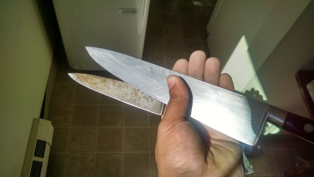

For example, I have a 5" carbon untilty knife and 10" stainless chef knife. Both with similar grinds, both dull with rounded tips, both sharpened free hand on a DMT extra coarse diamond stone.
The carbon blade removed material faster and left a sharper edge with less burr removing time the stainless however needed much more time to sharpen and remove the burr. It also holds its edge less.
Both were left finished on a extra coarse grit and stropped one deniem laid flat on the stone then pulled through soft wood to remove any stragglers.
The stainless takes more attention to detail and time and does not hold it edge.
Corrosion resistance is the only advantage for low end stainless.
