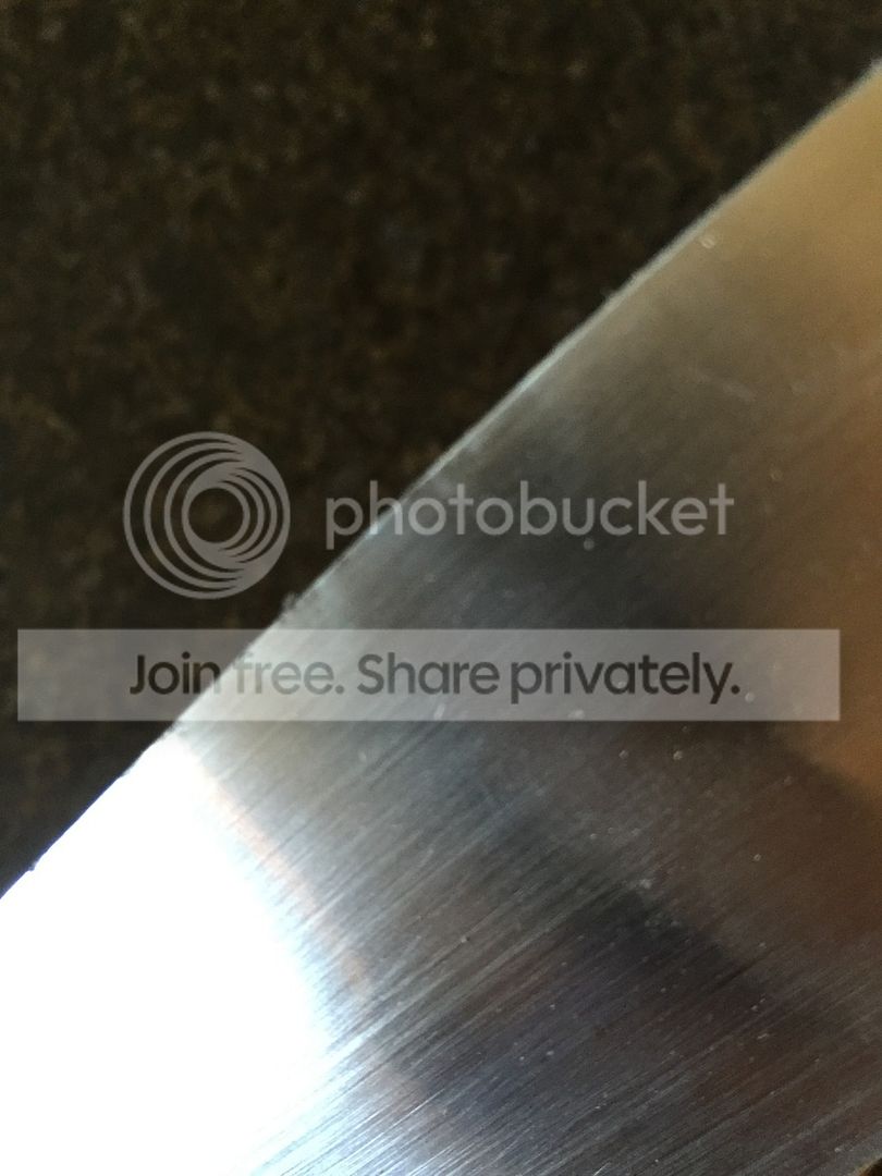

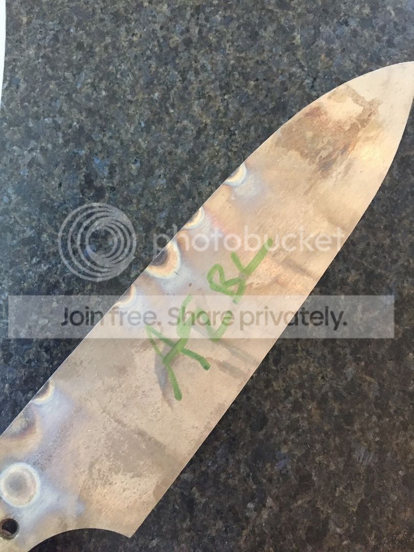

Hey guys,
I just got a batch of AEB-L and CPM154 back from HT. (Peter's HT) The first picture is what the blade looks like untouched after HT. I didn't think too much of the circular marks because they disappeared after surface grinding in preparation for bevel grinding. I ground the bevels without any noticeable marks and then began hand sanding when I noticed that the marks became visible again. It's subtle and not visible from all angles but definitely noticeable and unwanted. (second photo). I seem to recall a discussion like this before but I couldn't locate it. If it were during the work week I'd call Peter's (and probably still will) but thought I'd throw it out there to see what's going on. I know with carbon steel you can re HT but with stainless I'm not sure. Thoughts?

FYI: Just got off the phone with Brad at Peter's HT. What those spots represent are where they use a low temp torch to help straighten the blades. He said that most of the time it goes away with sanding. Interesting enough they do go away when I surface grind them (even with a fine grit A30 finishing belt) but re-appear with hand sanding (even at 320 grit). I'm going to try a cork belt and scotch-brite finish and if that doesn't work he's going to re heat treat them trying not to use the torch to straighten.
Yes, that is exactly what those spots are. They are part of their straightening process. I am sorry, I could have told you that when I first saw the thread...but I thought you were more worried about how to remove them...and it has always been a no issue for me. I've had them on an AEBL knife or two that had 400 grit finishes. Once I received them, a quick 400 grit re-sand and they came right out....just like tempering colors are supposed to come right out.

Work with a lot of AEB-L all heat treated by Peter's. I finish to a 220 grit Gator and then a Scotchbrite belt. The torch marks go completely away. Glad you called Brad. Never knew what those marks were. Never been a problem with this finish.
I took it back to the grinder and belt finished it like you describe. I went back to A300 gator up to A65 gator then scotch-brite. Looks good with no marks. Thanks Dave!
Just for fun I decided to scotch-brite the blade length wise the see if I could simulate a hand sanded finish. The marks became visible again even with the same scotch-brite belt I was using before. :confused: Maybe something about length wise finishes that reflect light just right to make the marks visible?

Lo/Rez....the marks are spots that are made by the small torch that Brad uses to straighten blades that are warped. If grinding post heat treat, then it's not an issue. But if grinding pre heat treat, as I most often do because of my limited equipment (way easier for me to grind soft steel...no belt grinder in shop), then warped blades post quench are just part of the game, sometimes. Yes, most usually the warp can be straightened during Ms-Mf with gloved hands, but sometimes a warp will not manifest itself until temper round 1. In that case, the 3 point clamp system for straightening blades is employed. But Brad has a different set up. Instead of 3 point clamp, he uses a small torch to warm the spine in the area of the bend, and then straightens it that way. This leaves tempering marks where the torch hit the spine.....which sand out just like any other tempering color mark. Hope that helps!

To me the most interesting thing about these particular blades is the fact that with certain finishes the marks are visible (length wise finish) but with standard perpendicular finishing they aren't visible.
