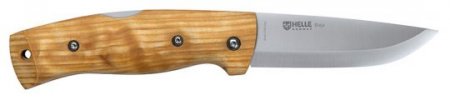

Being a fan of scandi grinds & puukkos myself, and having read through this thread, I went ahead and ordered the Roselli Carpenter in their UHC steel.
At the same time, I was browsing through the European retailer I was ordering from, and came across the Helle Bleja:
I much prefer folding knives for my personal needs and uses, but I could never find one with a true scandi grind that I liked. Enzo makes a few, but they all have one serious flaw or another that killed them for me - I've probably bought the Birk 75 at least four times trying to like it, but never did. This one, on the other hands, looks very promising - appears to be a true scandi, ergonomic handle, solid locking mechanism, etc. The steel could be better ("stainless" at 59HRC), but then Fallkniven seems to do well with their VG-10, so I can't knock it before trying it.
Anyway, it should be here in a week or so...
