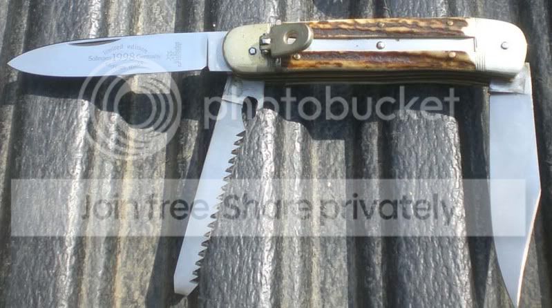

This is sort of like Nessmuks knife but with a saw. It's a Limited Edition 98 Custom Hubertus put out. I've never used this one but it's got a really nice combo of blades.

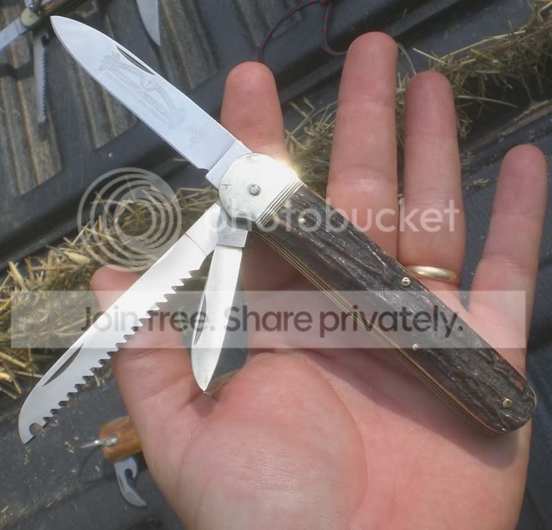

This one has really nice stag. Excuse the sucky pic. It's a Hubertus Forest Messer. I've actually used this one a bit. The saw is a bit longer than the others.

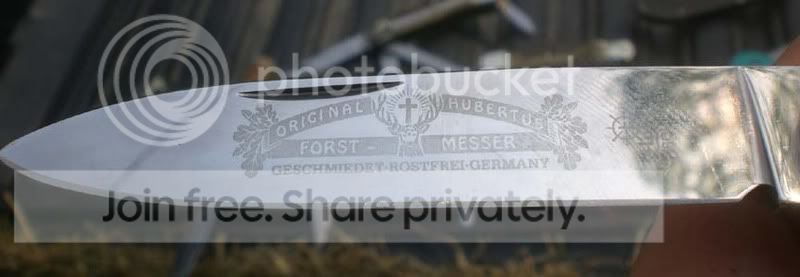

The Forest Messer also has an extremely cool blade etch

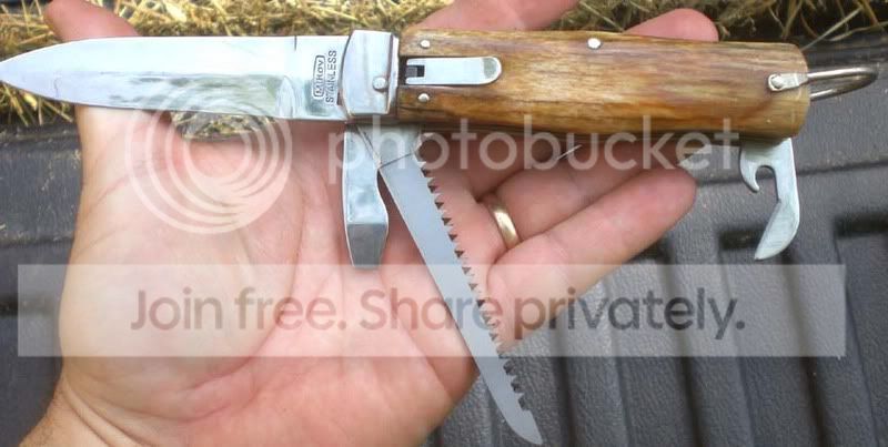

I had a knifemaker friend of mine combine 2 Mikov kits. The one w/ the bottle openers and the one with the saw into one huge camper. It's a handful and nearly a pound!

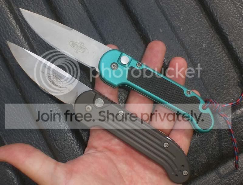

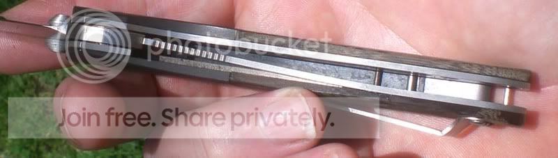

Here's 2 of my favorite auto probably next to the Hubies. The Microtech LUDT.
Check out the blade shape. Very nice. There is a blade, a body, a button, a button spring and a blade spring. Not that many moving parts considering. The green one is a 95 or 96 model, I've not used it much due to the collectible factor but the other a 2001 model has got used a LOT. Springs are widely available and you can take the whole thing apart with a torx.

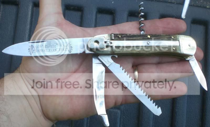

This is a blade I' have used quite a bit to gut deer. Got it full of blood and hair and it still worked fine.
It's a Ltd. Edition Hubertus Safari Club. I think they allegedly made these for some hunting club in South Africa.
Anyway I love that it has the little blade to get under the skin then you can open the deer up with the "gut" blade w/o puncturing the meat or bowels, then use the main blade and then celebrate by uncorking a bottle of wine:thumbup:

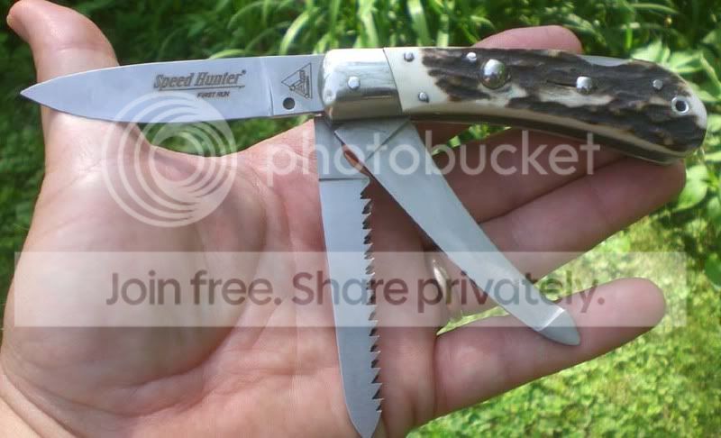

Also in the hunting mode is the AKC "Speed Hunter" It's not quite as well made as the Hubertus and the mechanisim is not as sturdy but it's also a good deal cheaper.
