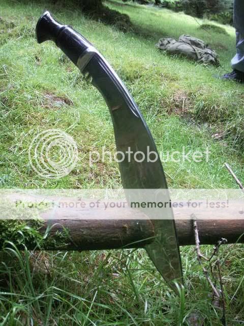

I use my El Mero Mero model ..01 tool steel 10 inch, recurve blade micarta handle.
That's a great looking knife bro, would make a perfect Camp blade !!!:thumbup:
