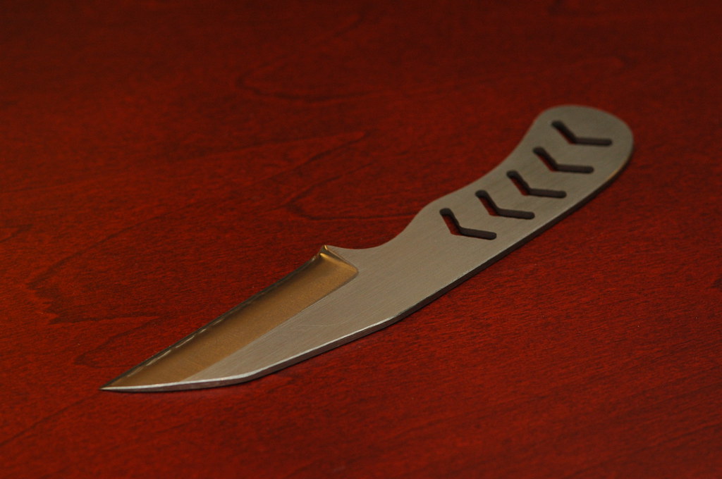

Because I have better things to spend my time on like this:
TAC Curve
Will be posting these up for on the exchange when I get back from class this evening.

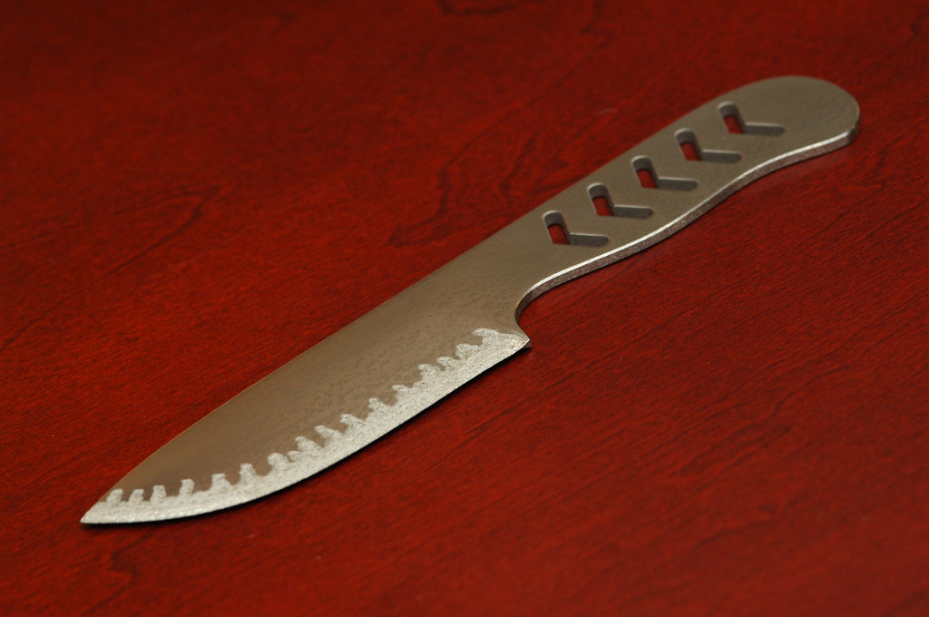

how do you sharpen blades like this? do you stay away from the carbide edged side and just sharpen the non-treated side (treating it kind of like a chisel grind?), or is that carbide impregnated side workable?
i've got a mini belt sander (Worksharp K&T) and a strop for my convex edges, and the spyderco sharpmaker for the rest of them. want to make sure i'm good to go / curious how to maintain the edges on these.
It is self sharpening for the most part because the softer Ti will slowly wear away exposing more carbides. But if you do need a quick touch up....then a few strops on the non carbide side should do the trick. :thumbup:
