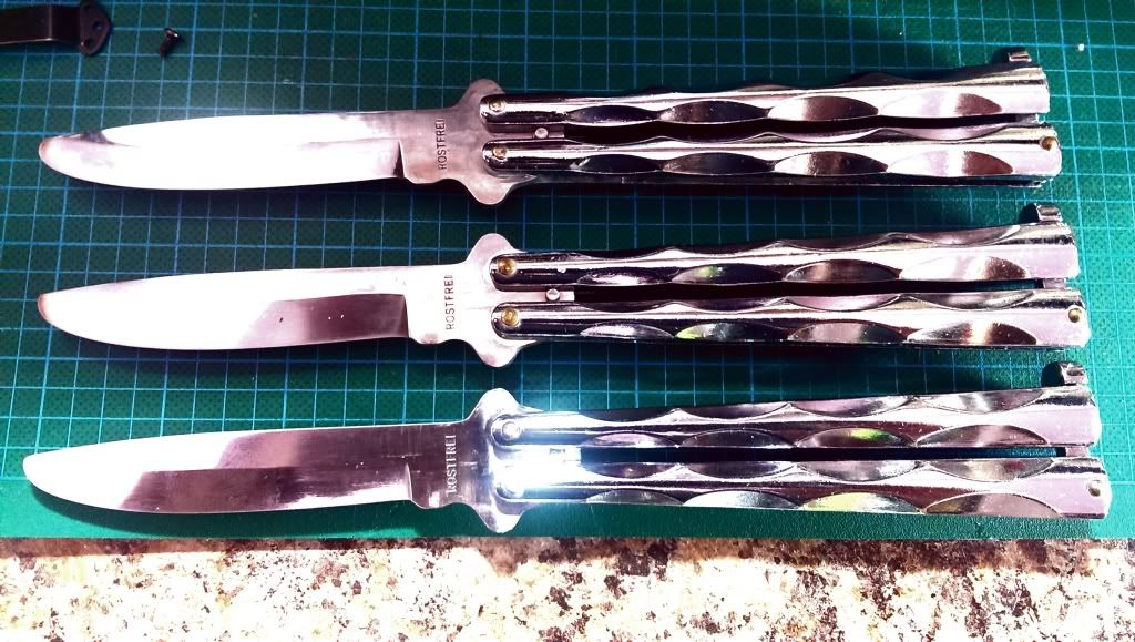

After reading this entire thread I've determined there is only one solution; to soley buy rosta-frei knives!
I've started collecting 'em already. ;)
