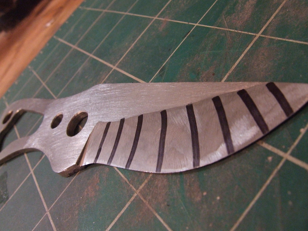

Update!

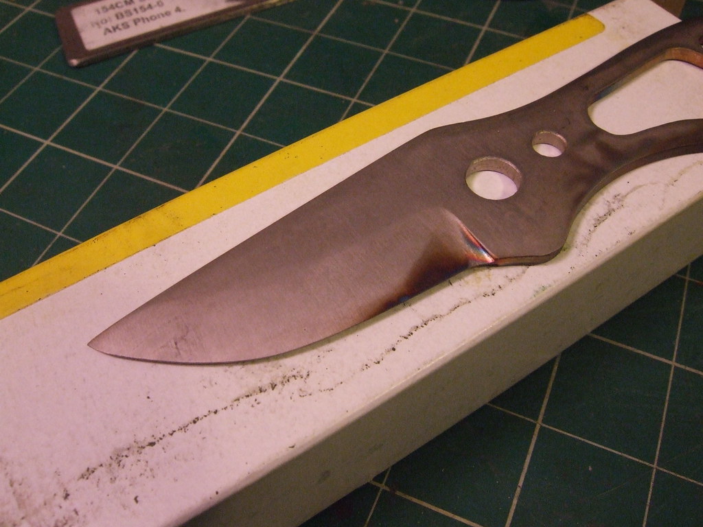

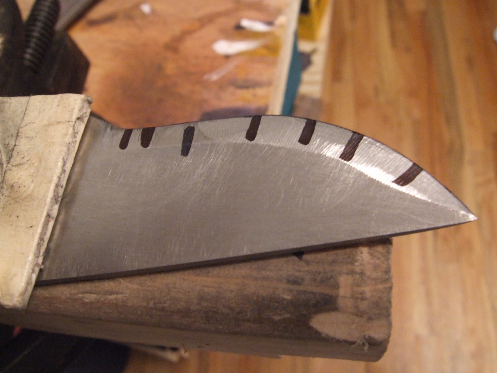

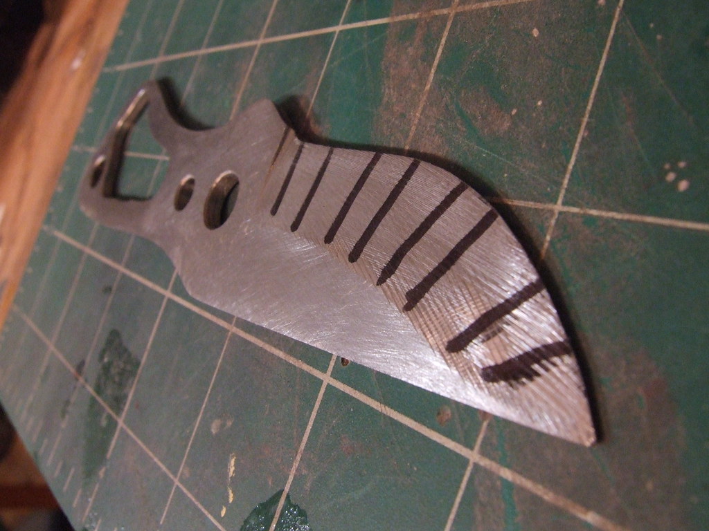

I created an edge fairly early in the filing of the bevels. It's a edge out on the belly area, and it is just a little off center. I am not sure how to correct it, but I think it would be difficult. I don't think it will make much difference in the useability/performance of the knife. I hope. :)
[Edit] As I continued filing, the edge apparently corrected itself. It's good now.
I filed these bevels pushing straight towards the edge. I did not do much draw filing. I think next I will start with my sanding block, and 80 grit.

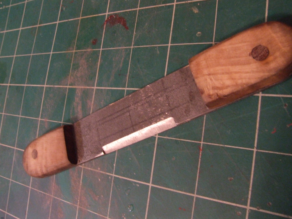

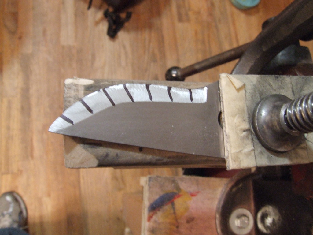

More Pictures. Here is a sanding block I made:

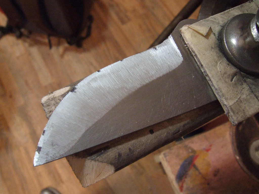

and a couple more pics of the bevels. It looks like I blunted the tip, but I think it is fixable. It looks worse in the pictures than it does IRL:
Looks good. Don't worry about the small places that go awry like the tip. They will get taken care of in the final shaping and sharpening after HT.
Your bevels look excellent.
The board you are clamping on will work fine, but if the tip is curved to match the blade, it will be easier to file/sand on.

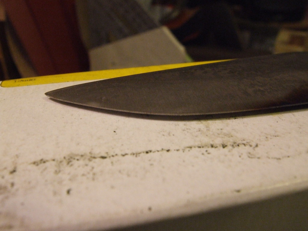

The one place I see you getting ahead of yourself is the edge. It should be a flat surface about as thick as a dime right now. If you don't leave enough metal there in the early filing and sanding stages, there will be three problems later on.
First, the edge should not be too thin when it goes to HT. This is a stainless steel blade, and you can get away with a pretty thin edge, but it should still be about .010" thick at HT.
Second, if you make the edge sharp as you file the bevels, and then continue to smooth and shape things, by the time the blade has been through HT and sanded to its final surface, then sharpened, the 1.25" wide blade may be only 1" wide.
Third, it is very easy to cut yourself while filing and sanding the blade if the edge gets a sharp spot. If the edge gets too thin, or worse - sharp, file it back a tad so it is a flat surface. This will take a tiny bit off the blade width, so try and avoid it happening too many times. When done sanding the bevels, sand the edge smooth and flat, with slightly rounded edges. This helps prevent the edge warping and cracking in HT.

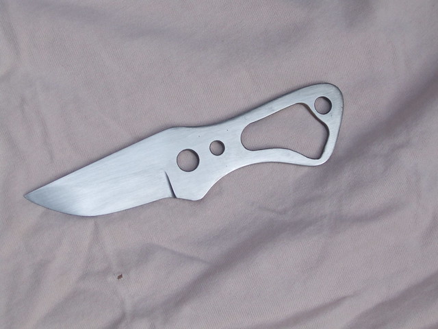

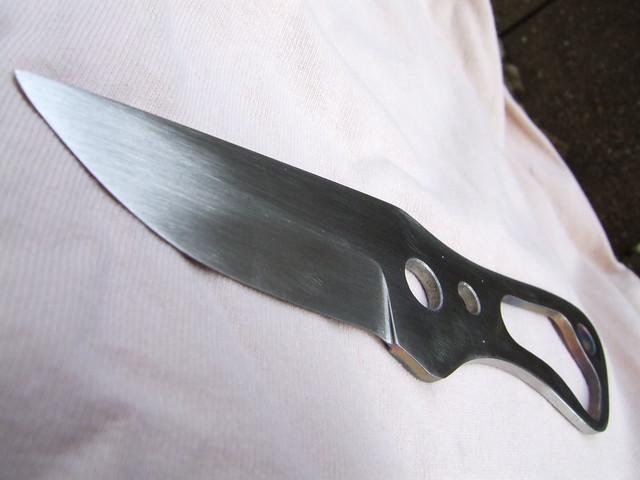

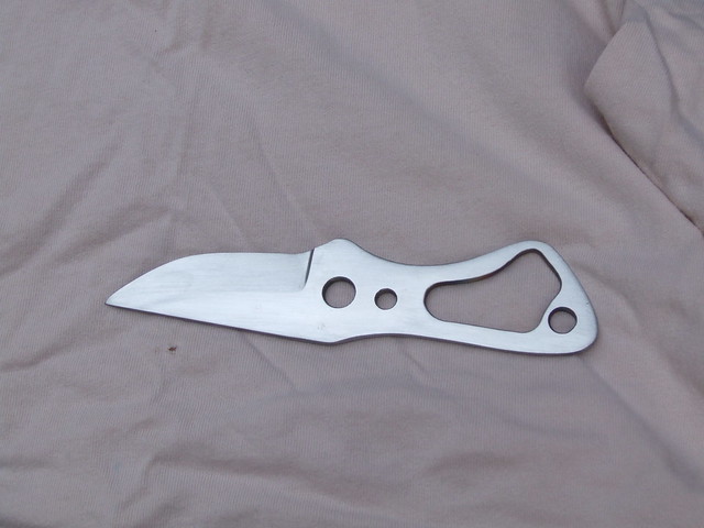

So far I am still working on that same blank, and I have sanded everything to 320 grit. There are still file marks on the tang. I will take the time to sand those out, because it is going to be just a minimalist neck knife -- no scales. Can't cover up my mistakes so I will correct them.

I find it very tricky to get the bevel looking truly flat. Still, I am happy with how it looks.

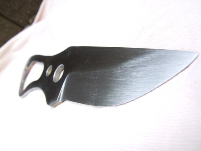

Stan shipped it back today. Said it tested at 59.5 RC. So awesome!
Pictures forthcoming. It came in the mail today. The more I handle it, the more I like the balance and feel. I will make a couple of different sheaths, for different carry options. I think it will mostly travel in my mess kit, inside the backpack.
Looking at the edge, I see I did a good job of making it thin, but not too thin. I don't remember exactly where I got my guideline on that, but the guideline was "1/3 mm before HT." I do not have calipers, and estimating 1/3 mm by eyesight is easy.
I expected the blade to be blackened, but it is just slightly discolored, like the color of oxidized aluminum.
Now I start sanding again.
Many thanks, Stan. I have confidence in your HT. I think it is rare to get stainless to 59.5 RC.
Got some sanding to do.
Sanded to 320 grit:

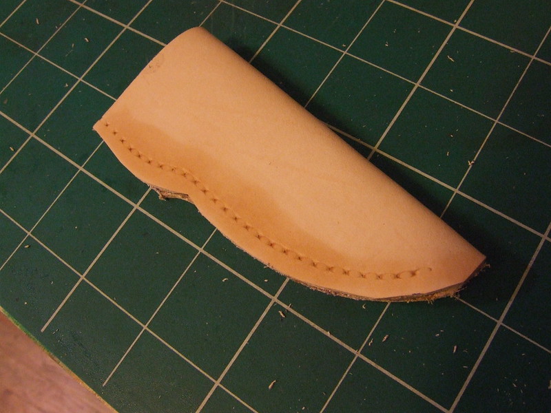

I think I will make a leather sheath for it, rather than kydex. Kydex always seems to scratch.

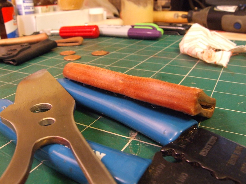

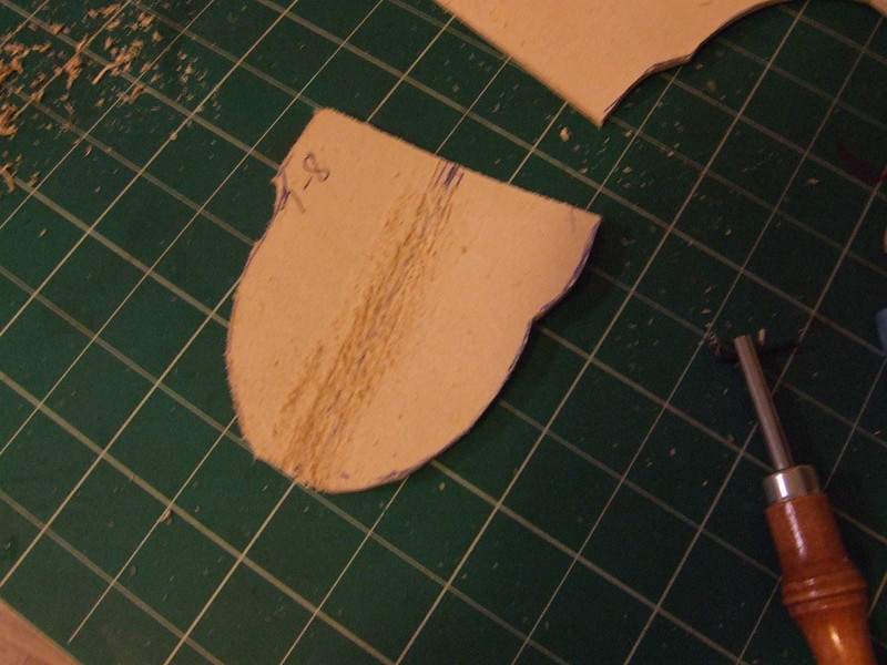

Pictures of sheath-making:
When I started out making the sheath, I thought the knife would just be travelling inside my mess kit, therefore no need for a belt loop. I am starting to change my mind now. It won't be too hard to add a loop.
I don't have a edge beveler, so I tried a potato peeler, and that didn't produce good results, so I didn't bevel the edges. I just sanded them and then burnished them.
For water resistance, I tried neatsfoot oil. According to what I have read, it will darken with exposure to sunlight.
