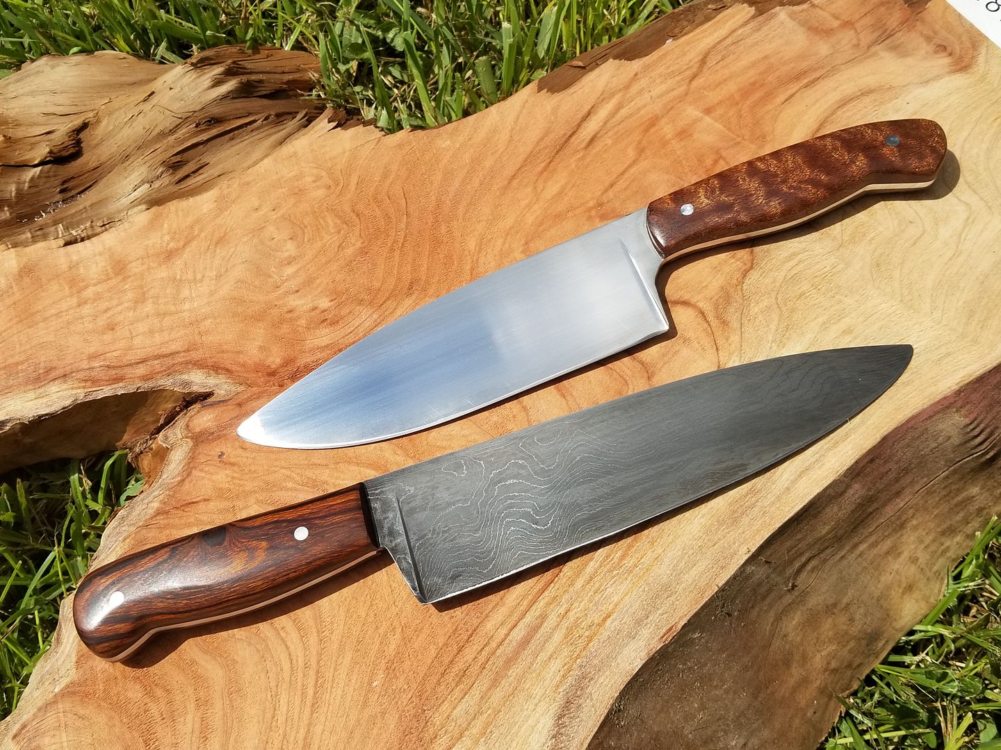

I like that shape ...........here they call them Serbian chef knives.I make this three for friend of my brother...Now I want one for me , i like how they cut :thumbsup:

this was just completed today and it’s a custom order Z wear at 64 Rockwell
