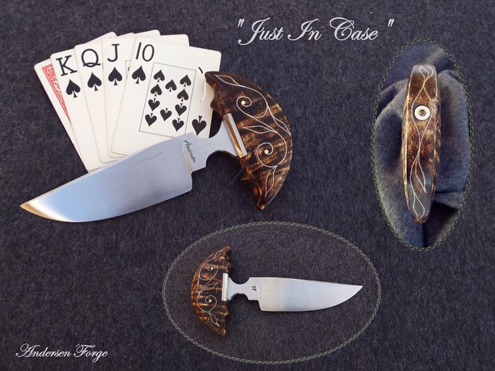

Patrice Lemée;12967914 said:
Another blade inlay possibility.
Sorry, already posted. I am slow. :(
Man, Patrice nice work.
