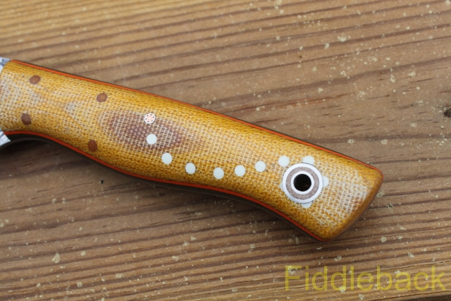

You can also do "silver pegging" or "pique" work by drilling holes in a pattern and inserting silver wire into the holes, then finishing flush. It's easier than the wire inlay and looks more distinctive in my opinion.
Good idea. I believe I've seen Andy do that in the past with phenolic pin stock. Very pretty in patterns. I believe there are examples of the idea in this very thread too.

I do a bit of this with phenolic pins.
