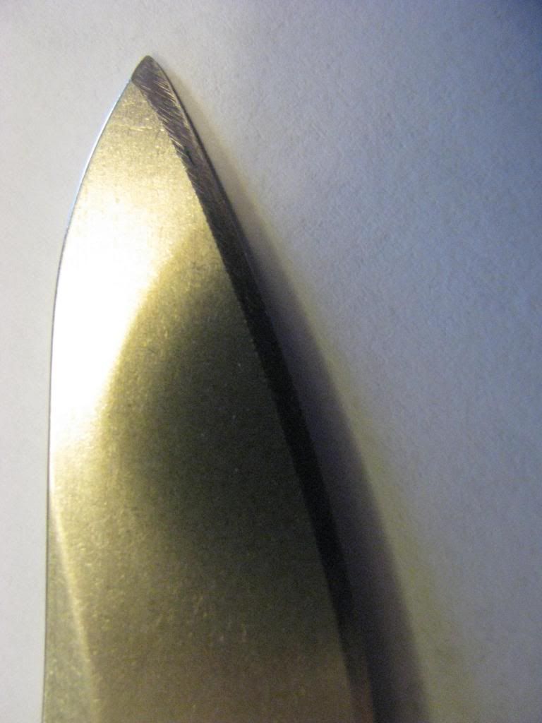

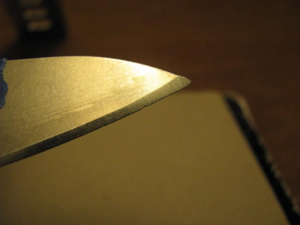

I personally, from just simple usage of a Para2 and Southard (CTS-204P, which I have heard their PM process is 3rd gen. vs. Bholer's 2nd gen.) and a Manix 2 in S110V, much prefer S110V. M390 and CTS-204P being super tough? Not from my experience. Not bad, but not anywhere near M4 or CRUWEAR. Here is a shot of what my Southard looked like after it hit one staple while opening a box. I have since had it reground to about .010" behind the edge and it did hold up very well while eating up some cardboard. My CRUWEAR Military on the other hand has hit staples and shrugged it off. That is some tough steel. Again all of this comes from usage and no testing/controls has been done.
I fixed the rolls/chips, but you can see the very tip is actually not apexed.
